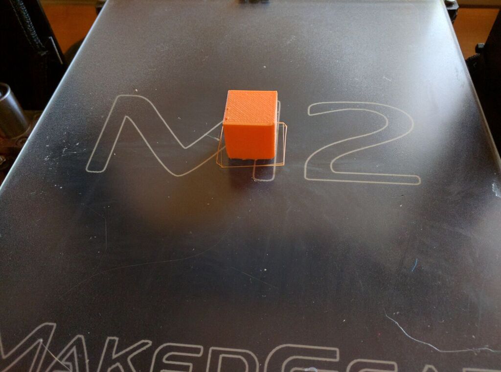

Re: first layer temperature
I was hopefull, for some reason I was able to print that cube, but I can't print much else
I don't know if these short videos will help at all, but looking for any help to get back to printing again...

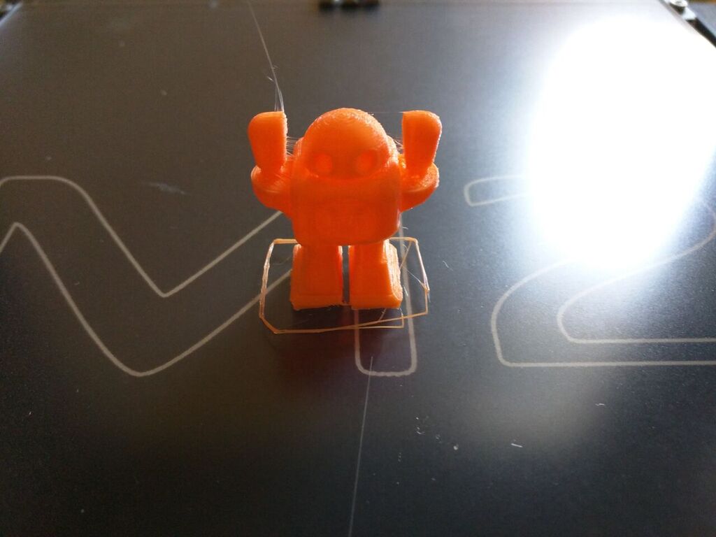

I did order some feeler guages...but until those come in.. I got my z-offset set to: -0.12 now. It doesn't look great to me, but at least it printed - so I'm pretty happy about that !
Thanks again Jules !
Looks much better! Might want to try some adhesive (hairspray) too while you're waiting on the gauges....it really helps the first layer to stick.
Don't forget, after you re-set the Z-Stop, the Z-Offset is going to change, and you need to re-run the calibrations. (Just once for each kind of filament though, and you can fine tune the Z-Offset number by going up or down by .02 mm increments until you get it just right. The thread will stick - it will be slightly squashed, and it's going to eliminate a lot of warping problems with the filament.)
