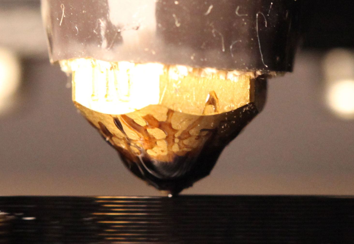

  2. The nozzle gets noticeably dirtier than PLA. Is that normal? Here's a mid-print pic I took (sorry for the poor quality...I used a macro lens with the head in motion and the focus was a bit off)

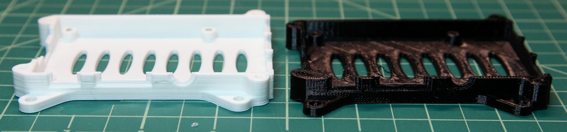

  3. Here's a RaspberryPi case from Thingiverse I printed nicely in MG white PLA vs the eSun (I realize the contrast on the PLA makes it difficult to see the layers). Dimensionally, it fits the Pi nicely just like the PLA print (and I understand for dimensional stability, you really can't beat PLA). Any tips to help with the cleanliness?
Yes, it does. That's the stickiness - and anything that cooks onto the nozzle can fall off as little carbonized bits later in your print. (Won't see it on the black of course, but it's a problem when printing the lighter colors.) I take the time to catch the initial purge to make sure that it doesn't get all wrapped up on the sides of the nozzle, and i'll sometimes carefully reach in with the tweezers and clean off a bit of gunk.
With PETG, you always want to clean off the nozzle after you finish printing (with the tweezers, while it cools) or you will be seeing the bits of it show up in your next print.

But also.....don't expect it to look like PLA. It's shinier, and in the opaque PETGs you will sometimes see marks in it from the travel movements. That's just the nature of PETG. (I prefer PLA for parts that don't require structural strength....it has a nicer finish on flat surfaces. PETG looks better on the sides if it's dialed in correctly, but you can always see a "texture" on flat surfaces when the light hits it.)
Oh, also be sure you adjusted your Filament Drive Screw tension for the PETG, it's a little bit different than PLA.
Your print doesn't look bad at all....I don't see a lot of stringing. (Heck of a lot better than my first shot at it!) :lol:

Yep...no worries there. My primary reason for PETG right now is for durability. I'm not worried about how it looks...I just want to dial in a durable filament that can stand up to heat and won't deteriorate in moderate humidity.
