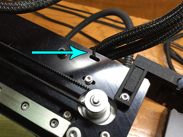

Yeah, I had something similar occur when I first tested the Rev.E, but you're the first customer to mention it, so I figured it was a one-off on the one I was testing. (My bed got caught on the wire harness while I was setting the Level and Starting Height, and got hung up. Didn't pull anything loose, but it wasn't going anywhere either, and it made an awful lot of noise until it was disconnected and disentangled.)
Yep...I should have mentioned it.
Looks like sometimes there might be a little bit too much slack in the wire harness. (I wonder now if that hasn't been responsible for some of the other stoppages that one or two other folks have seen lately.)
Here's how you can avoid the problem, and you're right - all it takes is an extra zip tie. Leave yourself enough slack in the harness that the print head can move all the way from side to side on the X-axis. (And mine has two harnesses showing, because it's now a dual.) You just need to take the slack out of the main harness along the right side support, and tie it up out of the way in that open rear slot.
Very simple fix. I'll flag Rick and Josh about it. Thanks for letting everybody know.
