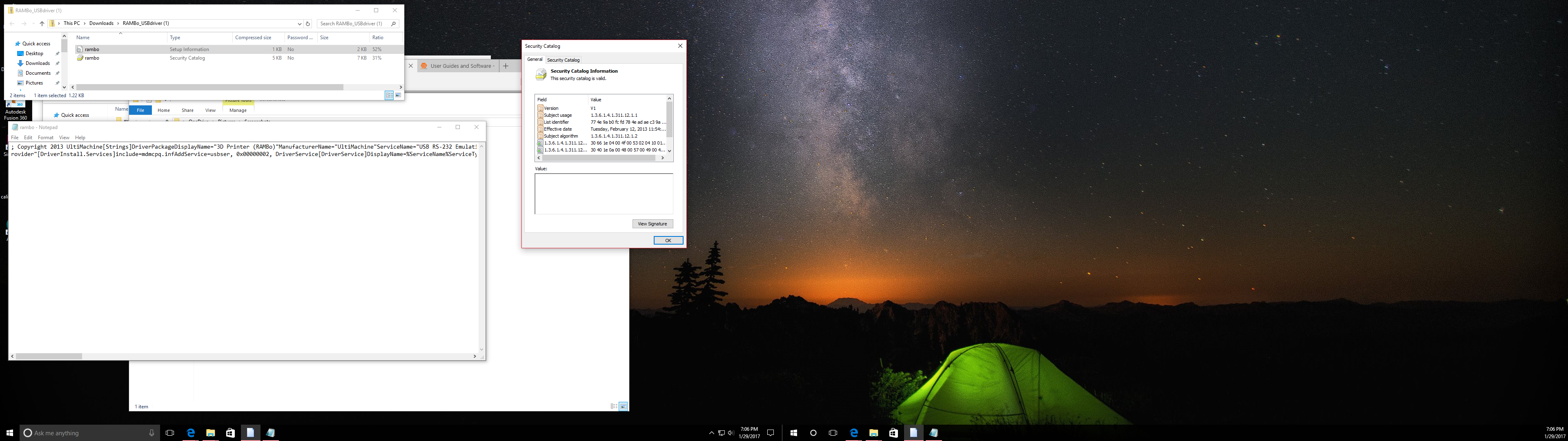

ok I downloaded Arduino 1.5.5. Now I have no clue on what to open up in the Arduino Sketch. I downloaded what she said and I get 2 folders. I open the folders and this is what I get (in the picture below). What is the problem? Am I not downloading the correct tings and also I'm running a dual extruders.

Don't worry about Arduino. Don't do anything in Arduino yet. If you have already correctly installed the firmware for the dual when you put that on, all you need to do is install that Windows Driver that i told you to go get in the earlier post.

So all I do is download the windows driver? Then what do I do with it? I have it downloaded but the printer still doesn't work. The dual extruder program is already uploaded onto the Rambo.
