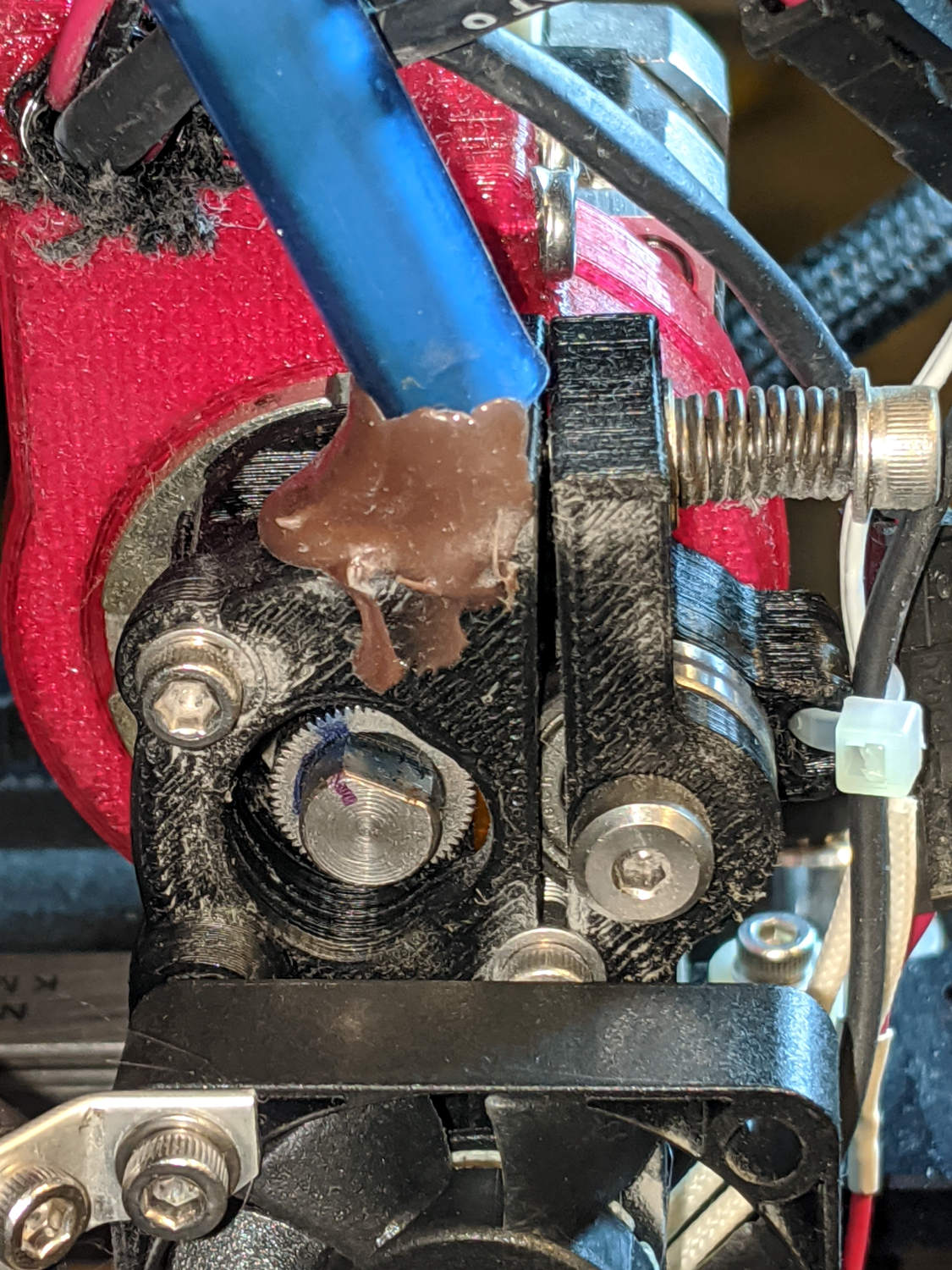

The only rotating parts you can see are the gear shaft (inside the filament drive gear):

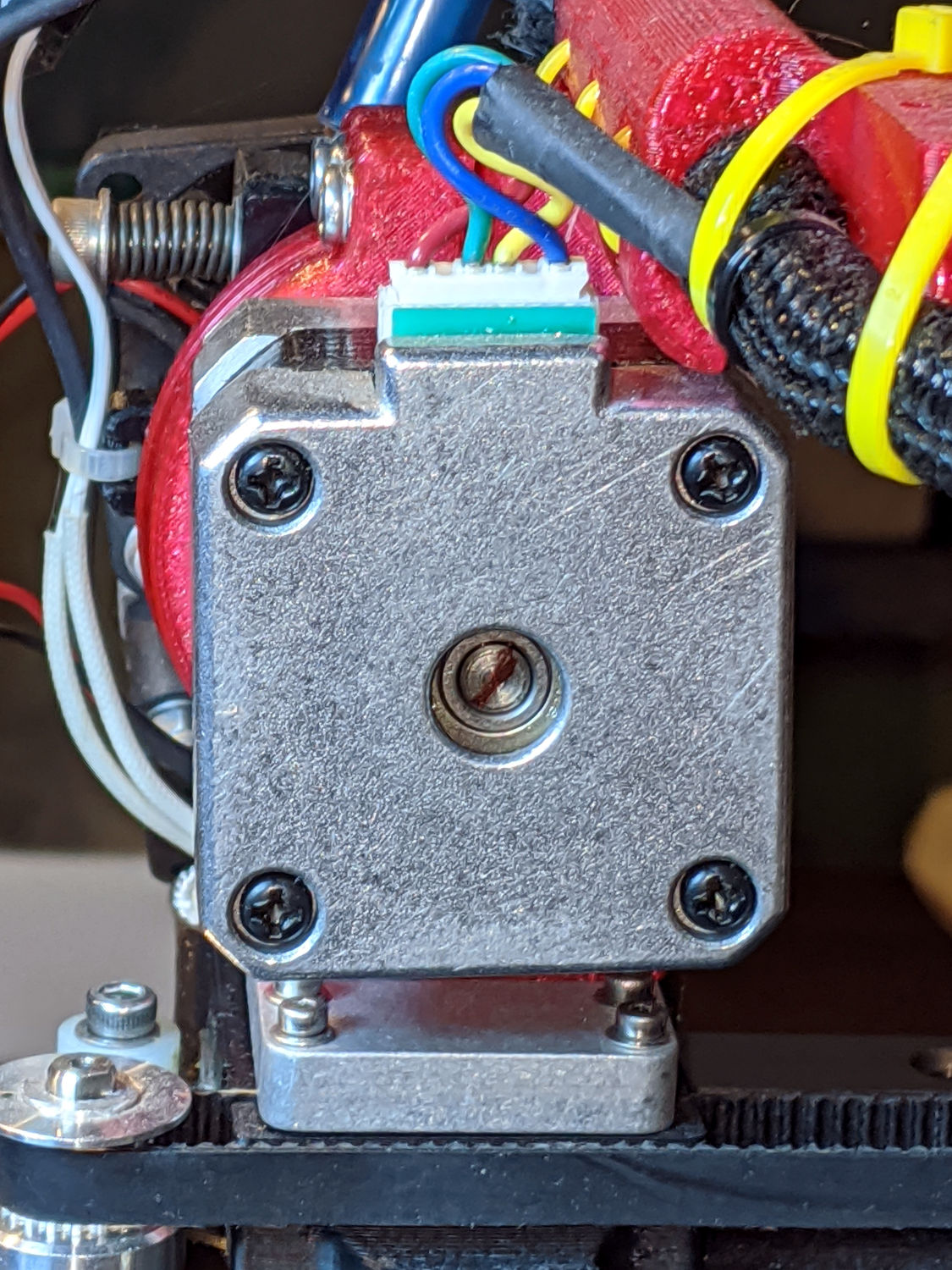

And the motor shaft (toward the gantry):
The gearbox has a 5:1 reduction, so the motor shaft turns much faster than the drive gear shaft. If the motor continues to turn while the drive gear doesn't, then the pinion gear inside the gearbox is defunct.
I drew those lines on the shafts & gear long ago and they're a great debugging tool for seeing what's turning in relation to what's not. Here's an earlier version of the drive gear in free air:
