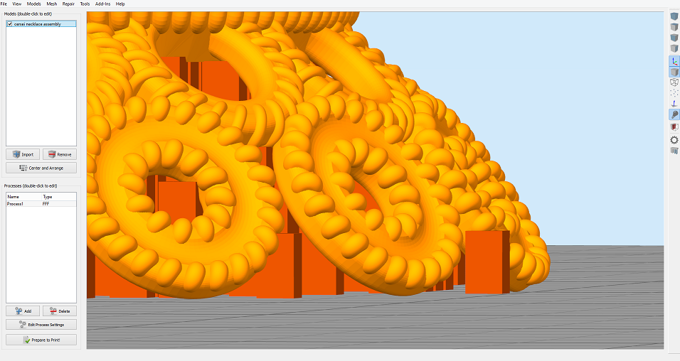

Here is the model in S3D.
stl on table.PNG (313.14 KiB) Viewed 6385 times

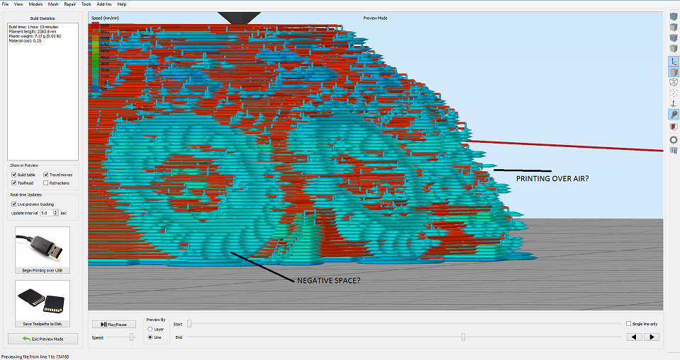

This is what I get after slicing it.

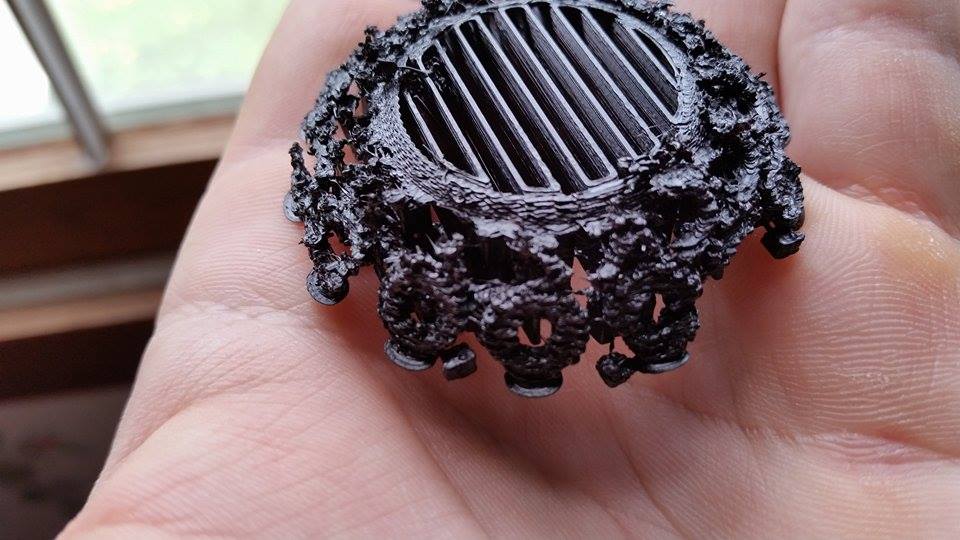

And here is the pint that I had to stop after I got a build-up on the nozzle.
pendant slicing print.jpg (80.29 KiB) Viewed 6385 times

Post by jsc » Sat May 02, 2015 6:47 pm
Are you sure those bumps aren't hollow on the inside?
jereywolf
Posts: 163
Re: Slicing help??
Post by jereywolf » Sat May 02, 2015 7:09 pm
After reading your response, I thought about the way that I built the file. It was exported from a Solidworks assembly and every single feature was a separate body. I went back to the model and combined everything into a single body and the preview looks spot on now. Thank you jsc! :D
