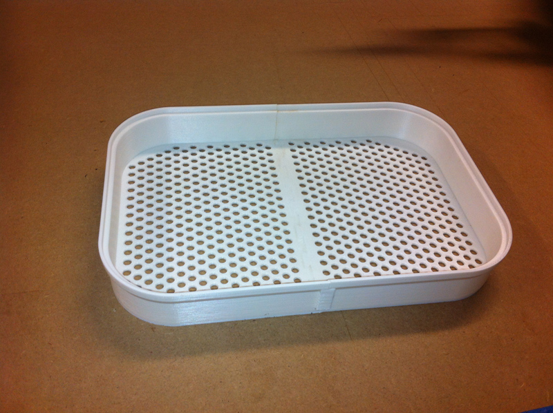

Here's what the finished screen looks like. These are called "star sizing screens" and are used in the fireworks industry for sorting spherical "stars" as they come out of the rolling machine used to make them. Stars are the points of light you see blooming out of a firework shell that bursts in the air, and they are just pellets of pyrotechnic composition that burn different colors or other effects. You get a range of different sizes when rolling them, then they must be sorted into groups that are all the same size for final use. Thus you need a screen for each size of star from 3/16 all the way up to 3/4, which is about 11 different sizes. The one seen here is 1/4". This is actually a pretty good application for 3D printing because the only alternative is to drill a bunch of holes on a drill press or CNC, which is tedious if done by hand.

Nice! I can think of at least half a a dozen uses for a nice little sorter screen set like that....are they on Thingie? :D
