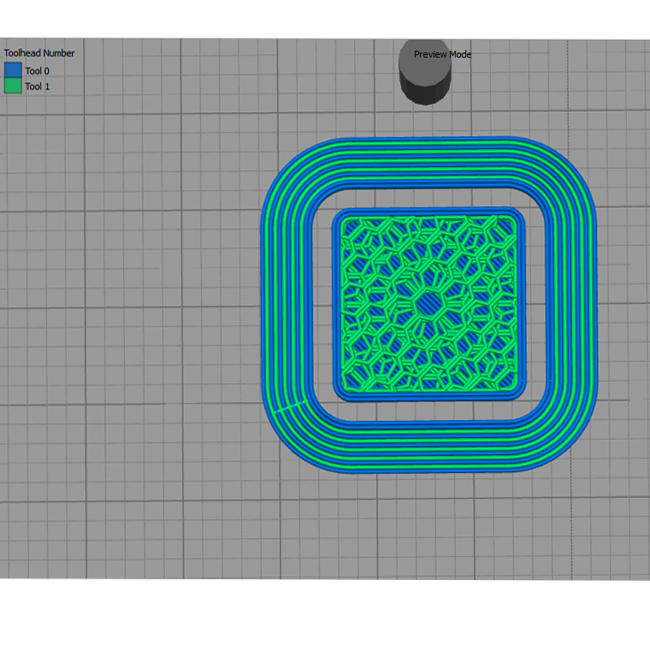

Hey Jim - remember that beautiful mandala pattern that i accidentally created with one of my prints when we were first testing the new S3Dv3? We never could figure out what caused it, and i thought it was a bug.
I figured out what i did, and how to recreate it. When I imported the FFF settings from version 2 , they had infill angles of 0°, 45° and -45° for the rectilinear infill. The default angle for the honeycomb patterns is just 0°.
But if you put the other two angles in there for infill direction, you get one snappy little fill pattern!

Looks like a decorative doily !!! When you get it to look like this I will be impressed !!! Lol ;-)

Think that one might be a bit out of reach! Chuckle! :lol:

thats funny jules. i got that pattern the other day and couldnt figure out what the deal was. i think i was using an old fff now that you mention it. must have been it. thanks for investigating!
