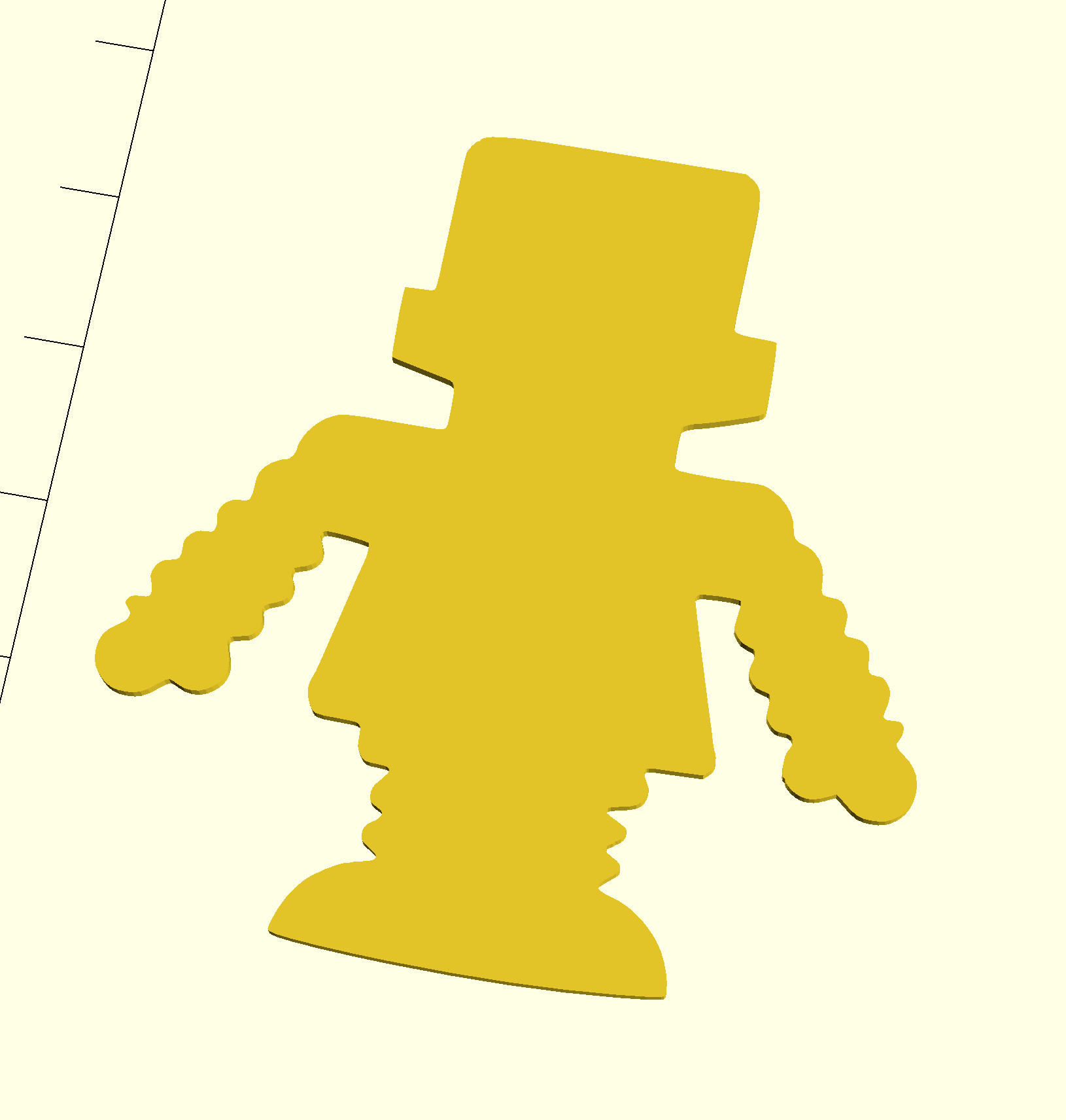

Either of those processes should give you a clean linear_extrude shape that exports into an STL file like this:
You can then punch that shape out of a slab without any hassle:

I just checked out your cookie cutter link, Ed. It appears things have improved since you wrote that. I used Inkscape autotrace (https://inkscape.org/en/doc/tracing/tut ... acing.html) and the Inkscape to OpenSCAD dxf tutorial you disparaged (http://repraprip.blogspot.com/2011/05/i ... orial.html) and ended up with this:
In Step 6 of the tutorial, I opted for the Extensions - Modify Path - Flatten Beziers option, which worked great.
If you want a through hole shape through your entire slab, you can even export an inverse path by differencing in Inkscape and extruding that instead of differencing within OpenSCAD.
