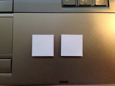

by Rara » Sun Jul 24, 2016 9:18 pm
I was using the 4800 mm/min that was set by default. Dropped to 3600...no difference.
For the hell of it I printed one at 2000; and it was in fact better. But, yeah, agonizingly slow! On the left, with just a slight amount of gaps as you can see, multiplier 1.00 and on the right I jumped to 1.06. Maybe it is filament...?
2012 M2 V4-PTFE
- Posts: 3144
Post
by Jules » Sun Jul 24, 2016 10:45 pm
Heck, maybe it is....I'm out of ideas.
