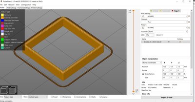

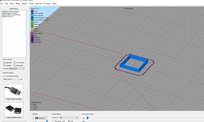

After the last upgrade or S3D which I did not install and there lack of any real progress, I have started looking at Prusaslicer which was branched from Slic3r and developed by pruas for there machines. It is still open source and very much like S3D. Their branch as been converted from perl to C so it is as fast as S3D and does not crash and hang like Slic3r.
I spent an afternoon with Slic3r 1.3 and got a working profile for my M2, exported the profile bundle and imported it into Prusaslicer. There will be some tuning as all I did was print 2 walled squares. Speed parameters are many and most of them I just winged so keep in mind . This is for the .5 nozzle with a .5 extrusion width and PLA Lots to tweak but function. Version 2.1.1 can be found here https://github.com/prusa3d/PrusaSlicer/ ... sion_2.1.1
