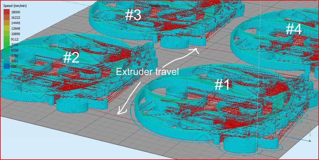

In sequence mode set at a 6mm height with 4 models and their respective processes, S3D wants to bury the extruder into the first model after completing it-maybe trying to reach z=0 -and then drags right through the first model ripping up everything in its path and twisting the extruder in its housing. All my settings as far as I can see, match other sequence prints I've done in earlier versions of the program successfully. I can see from the trace lines in the slice window the extruder is burying itself into the model instead of lifting to traverse over the model. Anyone else come across this accurance or can link me to some help? Thanks a bunch.

Whoops, got away on me. Here's the FFF and a pic of the slice. Guess I don't know how to uplaod an FFF file as it doesn't show up.
- Check out how the trace line is coming from under the model after it is complete.
- S3D slice.JPG (596.32 KiB) Viewed 17410 times

As mentioned I've printed in sequential mode many times and was suprised as hell when the hot end dropped into the first model and tried reaching z=0 then moving to the next model. Height input setting is high enough to clear the model height as I stated earlier but still crashes. The model height setting i believe, tells the printer to stop printing at that height then move along to the second sequence, nothing to do with clearing the model height. In sequence mode I believe the program knows to clear any model it's already built so I have no control over that perameter unless a new perameter was added that I'm missing. Waiting to hear from S3D support because I do believe I've just entered the "TWILIGHT ZONE".jsc wrote:Also, when you are printing multiple models, you are given the option of doing it layer by layer, or sequential printing. Sequential prints one model, and then the next, etc. You are responsible to make sure you do not get head crashes in this mode, I believe. It is only very rarely useful, make sure you are printing layer by layer.

Jimc, that tutorial is actually where I learned how to do sequential printing and refer to it when having any problems. Unfortunately it doesn't cover my issue. The clearance issues the tutorial goes into is the clearance around a printed part so the part doesn't collide with any part of the printer machine itself. S3D is suppose to remember where it printed a part so it will not collide with those previous prints while traversing the bed. Not so anymore. This is a huge bummer as I do a lot of sequence printing.
