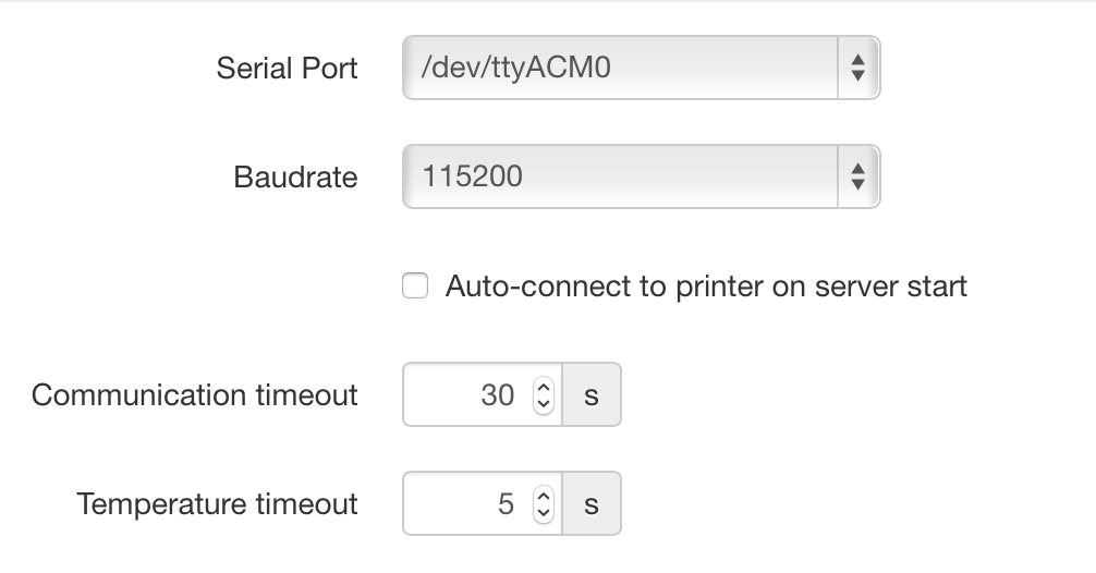

Looking through the source, it appears to be controlled by a parameter in config.yaml. Oh, there it is, in settings:
Under Serial Connection, Temperature Timeout. Mine says 5s.

No, from what I can see, it directly uses that value to create the temperature poller:
def _onConnected(self):
self._temperature_timer = RepeatedTimer(lambda: get_interval("temperature"), self._poll_temperature, run_first=True)
self._temperature_timer.start()
Are you changing this setting:
Screen Shot 2015-04-14 at 11.55.19 PM.png (50.19 KiB) Viewed 16545 times
Re: Just setup OctoPrint. Any tips?
Post by jimc » Wed Apr 15, 2015 4:59 am
yes the temp timeout. seems to have no effect on how fast mine responds. i set it to 1 sec, rebooted and it was till a good solid 10+ sec between the m105 being sent. i just checked it with a stopwatch. 11sec
