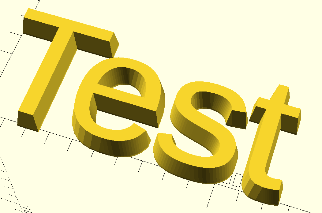

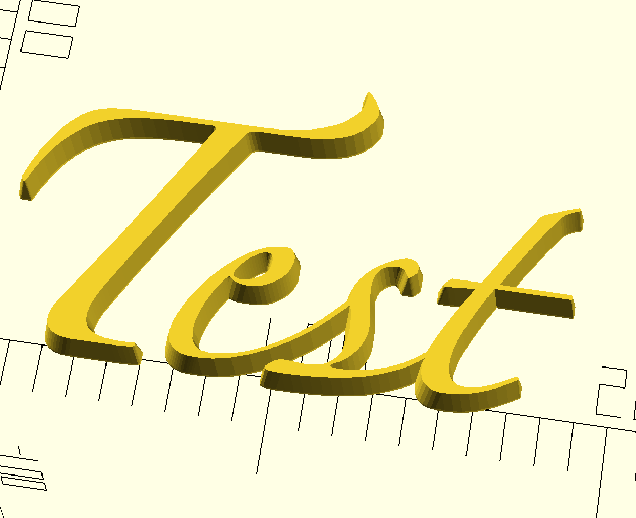

Working off of Jin's excellent suggestion, the following works pretty well and is not nearly so computationally expensive. You might not have to wait days for the result. The trick here is to use a 4-sided tapered cylinder for the Minkowski hull, and rotate it 45 degrees so that the corners are square.
Also, with a nod to insta's comment, if you did this, it would be wise to save the result as STL and import it back into OpenSCAD when using the text as a cut-out of another object, because the OpenSCAD will handle the STL much quicker than doing the Minkowski hull computations.

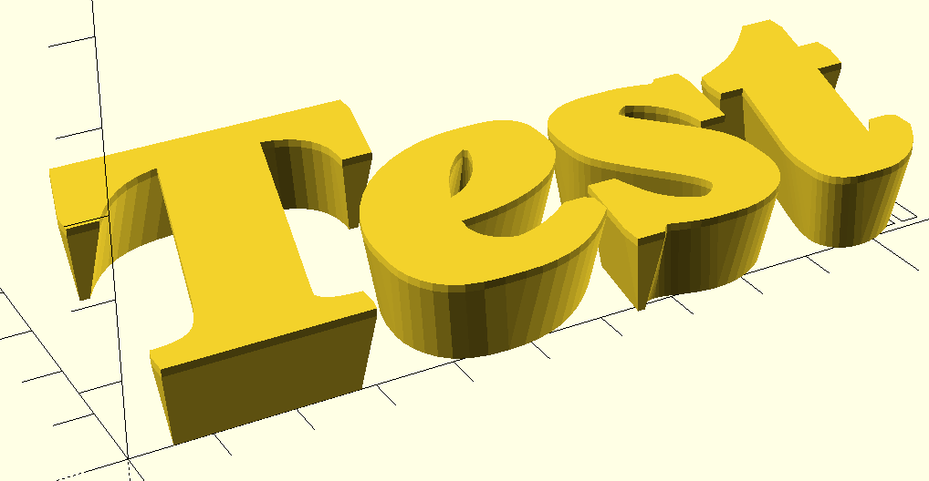

And just to point out, that although the examples Jin and I were showing were opposite of what was asked for, to get the right effect for lettering to be cut into a surface, you just need to turn the cone upside-down.
(edit) I re-read Jules' post and realize that the idea was to make something to imprint into a surface, so the original direction was right, but what the heck, just to show what can be done. . .
(re-edit) Okay, yes, I was right the first time.
Code: Select all
module t() {
scale([5, 5, 1]) text("Test", font="Times New Roman:style=Bold Italic");
minkowski() {
linear_extrude(1) t();
scale([2, 2, 10]) rotate([0, 0, 45]) cylinder(r1=0, r2=1, $fn=4);
