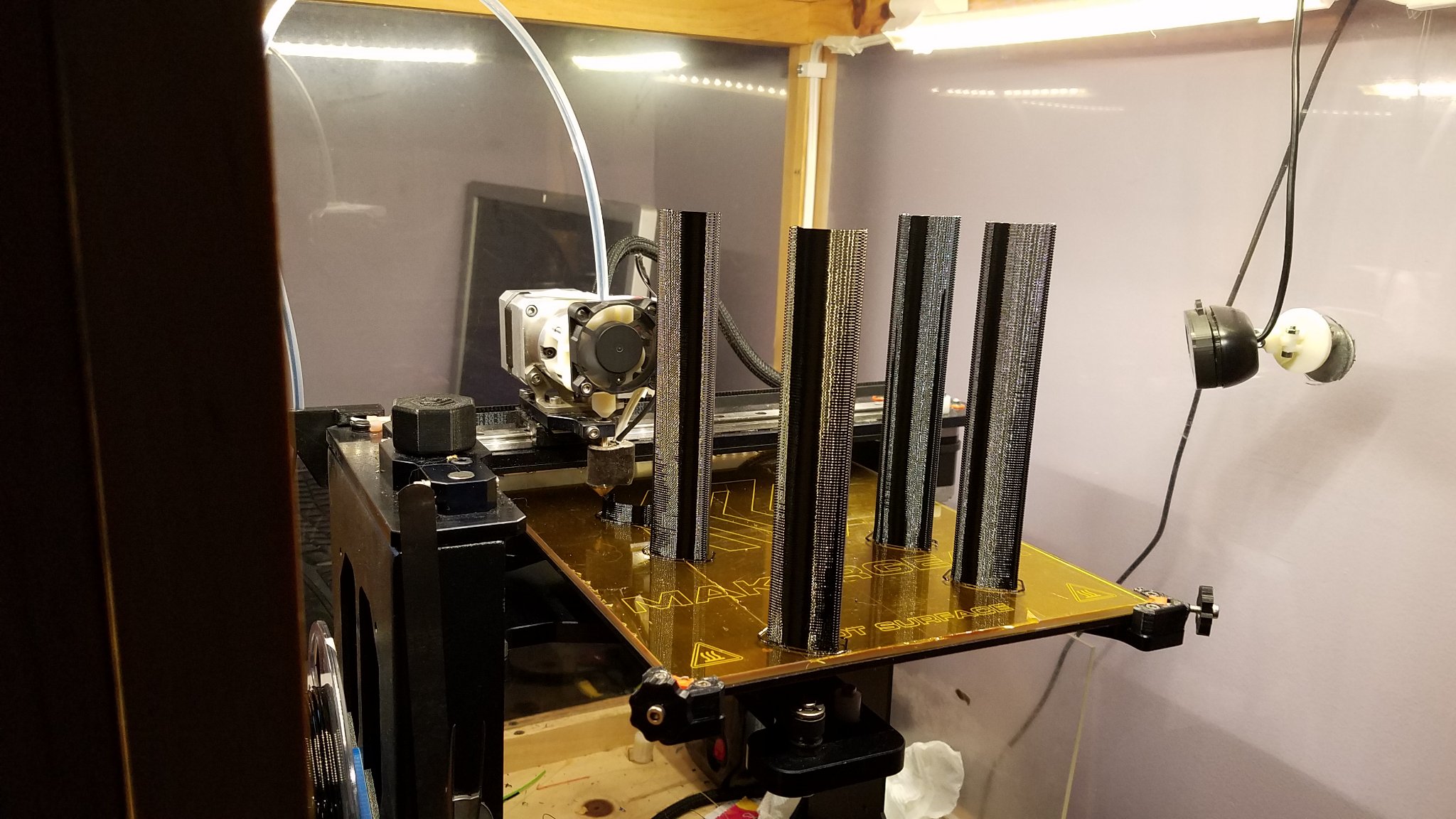

Post by airscapes » Thu Dec 31, 2020 7:54 pm
With the M2 and the Z offset set correctly for the layer height and no squish with the slicer, petg will hold well at 60C on Polymide and pop off with a tap of a wooden handle. I do a lot of PETG as well.. maybe I will try that flex stuff some day, just can not imagine it flat with in .02 mm like the glass is. I really don't change much between filament materials.. temp maybe retraction a bit.. changes are more dictated by the model size and shape than filament material. PETG to ABS is virtually no change.. hotter bed for ABS.. Like Ed, I have learned that way a part looks is not as important as how it hold up.. Attaching a photo of some PETG parts I sell printed with .75 nozzle sequentially with S3D.. can you do multiple processes with PS and print sequentially like this?

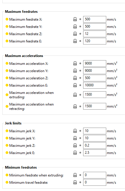

I'm still learning my way around PrusaSlicer 2.3. I imported airscapes' config for the M2E, and it shows up in the upper right hand pull down list. However, I wanted to check the settings, but it doesn't show up in the pull-down list under Printer Settings on the left. I need to change the nozzle size, for example.
With no obvious way to check/change things, I decided to learn how to set up a config from scratch. I'm about half way through the YouTube tutorial, and for the most part, so far so good. One of the things it wants is "Machine limits" on things like speeds, acceleration, jerk & feedrates:
Does anyone know where I can find this info? I checked the M2E documentation online and came up empty. It may be buried in my S3D config, but I'm not sure where to look.
Any ideas?
Thanks!
Posts: 599
Re: Prusaslicer 2.x
Post by airscapes » Thu Dec 31, 2020 8:37 pm
Check the output of M503
I am fairly sure I am stock but I also only half understand it..
Also may be in here someplace http://makergear.wikidot.com/m2-technical-guide
Send: M503
Recv: echo:Steps per unit:
Recv: echo: M92 X88.88 Y88.88 Z1007.70 E471.50
Recv: echo:Maximum feedrates (mm/s):
Recv: echo: M203 X200.00 Y200.00 Z25.00 E25.00
Recv: echo:Maximum Acceleration (mm/s2):
Recv: echo: M201 X900 Y1000 Z30 E1000
Recv: echo:Acceleration: S=acceleration, T=retract acceleration
Recv: echo: M204 S2000.00 T3000.00
Recv: echo:Advanced variables: S=Min feedrate (mm/s), T=Min travel feedrate (mm/s), B=minimum segment time (ms), X=maximum XY jerk (mm/s), Z=maximum Z jerk (mm/s), E=maximum E jerk (mm/s)
Recv: echo: M205 S0.00 T0.00 B20000 X4.00 Z0.44 E1.00
Recv: echo:Home offset (mm):
Recv: echo: M206 X0.00 Y0.00 Z12.41
Recv: echo:PID settings:
Recv: echo: M301 P19.97 I1.39 D71.56
Recv: ok
Gwhite
Posts: 381
Re: Prusaslicer 2.x
Post by Gwhite » Thu Dec 31, 2020 9:19 pm
Thanks! I gave that a go. I got:
Steps per unit:
M201 X900 Y1000 Z30 E2000
M205 S0.00 T0.00 B20000 X4.00 Z0.40 E1.00
Home offset (mm):
M206 X0.00 Y0.00 Z11.91
PID settings:
M301 P25.89 I1.94 D86.53
I checked it over, and everything is the same as the one above except for two settings. My extruder acceleration (M201) is at 2000, vs 1000 on yours. Any idea what's up with that? Mine was bought in July of 2017. It may be that they backed off on that in newer ones.
Also, my Z Home Offset (M206) is half a mm different. I suspect this comes from the bed leveling process, but if so, that will vary with how high you clamp the hot end.
The one piece of this that has me nervous is that the M2E zeroes Z at the bottom, while Z=0 for printing is at the top. I know someone tried to set up a Cura config & had a problem with slamming their hot end into their build plate. I haven't seen any place that appears to address that, but maybe it's all swept under the rug in the firmware.
