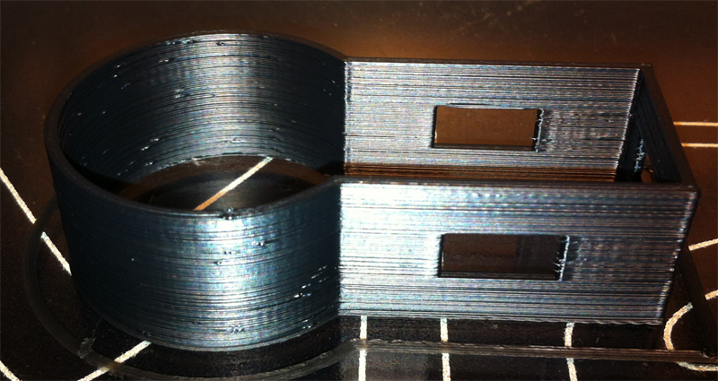

that is unreasonable. you could be severely over extruding. what is your ext width set to? did you mic the filament and get that value set? how about your multiplier setting? the jog dial on the control panel...is that set at 100%. when you extrude 2 lines side by side by side the edges should just touch. the nozzle should not be pushing plastic around. do you have any pictures you could post?

Ext width is manual .35
Ext multipler is .9
jog dial is 100%
filament miced at 1.75 pretty consistently and is set to that on the Other tab
a wall width of 1.17 in the CAD is printing at 1.38 though, using three parallel lines to produce it.
The print below is the best attempt so far using my test model which checks both curved and flat walls as well as cutouts. The flat walls actually don't have any stop points in them except for one or two at the very edge, so it doesn't really check for warts on non-curved surfaces very well. Coast is 7mm, retraction is 3, M201 acceleration is set to 900, print speed is 4800, outline underspeed is 50%, layer height is .2 and wipe/restart distances are turned off because they were not having any effect. Wipe would usually cause a set of two bumps separated by the wipe distance instead of one, so it actually made the problem worse. One interesting thing in the window cutouts is that on the right edge you can see the blob problem effecting the edge, but on the left edge it does not happen. A reversal is happening at each edge, so I don't know why there would be a blob going one direction but not the other.
