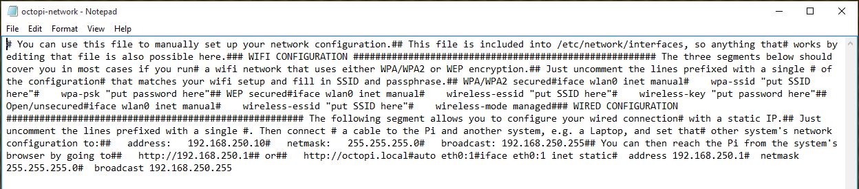

funny, did your txt file look all organized into lines like that? no matter what text editor i opened it up into it would open it as a jumbled mess with no returns, spaces or anything else. it was one big massive run on sentence. thats half the reason i couldnt make heads or tales of it. ill try and mess with this later. thx

yes that was exactly how it opens in windows notepad.
Re: anyone using octoprint 1.2.2?
Post by jimc » Sun Jul 26, 2015 5:04 pm
weird. i used notepad on the pc and 2 others on the mac. was just a big unreadable mess. i can atleast see what is going on now. its a little more understandable. so i basically just remove the single pound sign from in front of each line i want to use and enter the network info?

Yes exactly. Wonder if you got a corrupted download ?

PcS wrote:Wonder if you got a corrupted download ?
Nope, it's in Unix text file format, with line endings marked by Line Feed (hex 0A) characters.
DOS, for obscure reasons, and therefore Windows require Carriage Return (hex 0D) and Line Feed characters at the end of each line.

Post by jimc » Sun Jul 26, 2015 8:08 pm
your right once again ed.
when i opened that file with notepad this is what i got.
i must have been mistaken though as to what i used to open it with because notepad looks like the pic but wordpad opens it correctly like mentioned in ed's link. also i drug it over to my mac and it opened right with textedit and text wrangler.
