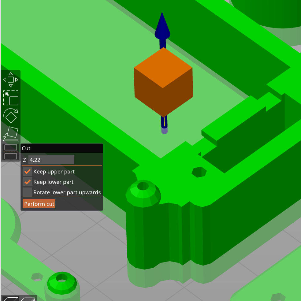

I need to fine tune some things. In S3D, I could use copies of the same model, and assign slightly different processes to each one. I have no idea how to do that efficiently in PS.
Also, most of what I want to work on can be determined in the first couple mm of the model. For example, I have text & a logo inset in the bottom, and I only need to print the first 6 layers or so to see what is going on there. In S3d, I can just go in and tell is to stop printing 6 layers up. Again, I have no idea how to do that in PS. I know there are some settings you can add with the vertical slider in preview mode, but the one example I saw was someone inserting custom gcode to pause a print. Even if I want to go that route, I'm not sure how to tell it to stop, and then run my ending script.

Re: Prusaslicer 2.x
Post by ednisley » Sat Jan 09, 2021 5:09 pm
Gwhite wrote:
Fri Jan 08, 2021 3:04 pm
Click the Cut icon over on the left, uncheck Keep Upper Part, click-n-drag the cube in the middle to suit, click Perform Cut, and it's done.
