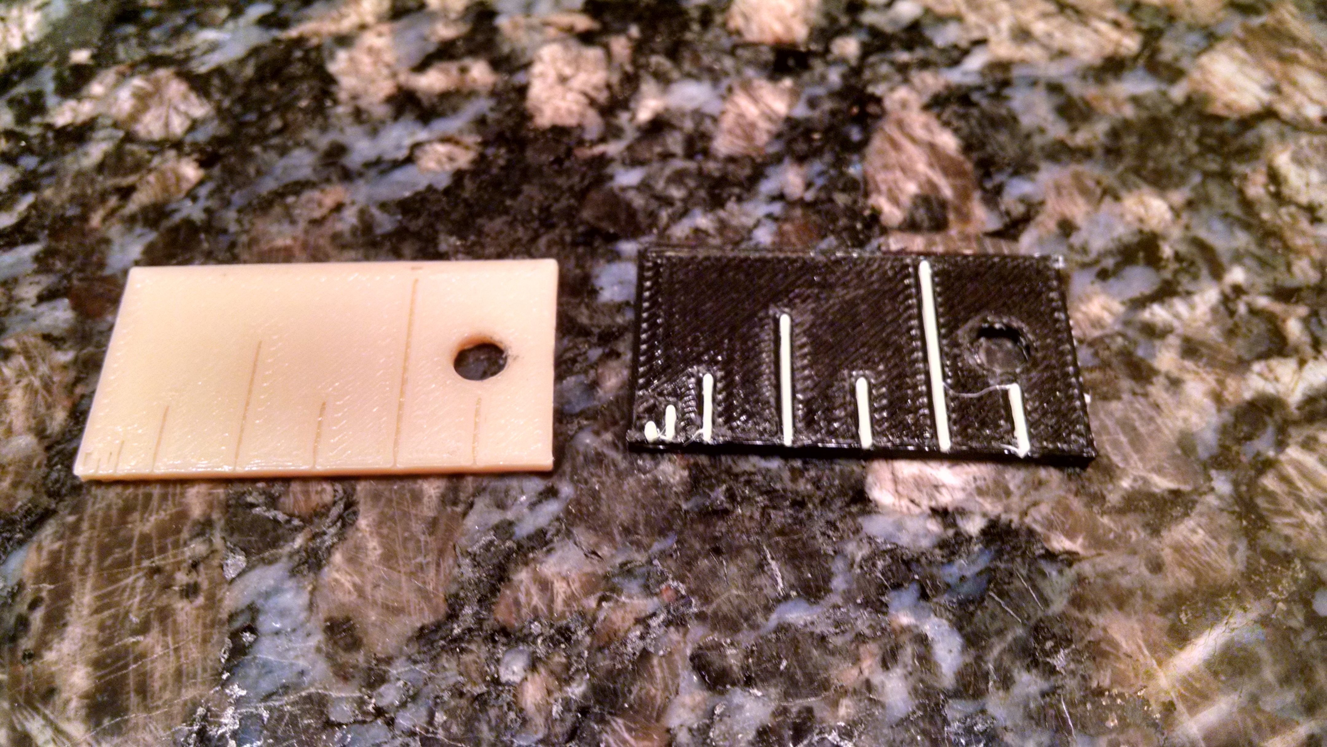

Tried out the dual extruder enhancements just now with a keychain ruler I designed. I selected ooze shield, but not wipe tower. The black printed with the left extruder and the white the right. The startup sequence primed both nozzles which was new and good. But the ooze shield didn't print until AFTER the first layer of black went down so it was contaminated with wiped in white plastic - not correct. Fortunately it mostly sorted itself out in the end - the contamination was only a little visible on the outside edges. I also noticed that both nozzles were powered off at the end - previously the second nozzle was left hot - very bad. The version on the left is my previous version, the dual is much better because you can see the lines - I made the lines 1/32" recessed and raised above the surface of the black.

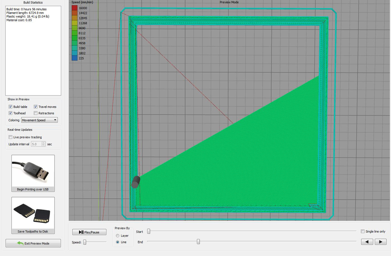

Post by Jules » Wed Jul 01, 2015 2:34 am
Holeeeee Cow! Okay, how much of a gap do you think you can bridge with PLA?.....Take a wild guess.
The answer is five inches on a diagonal! That's 120 mm folks! I'd be tremendously impressed if I had wanted the rim that I was printing to be bridged. :shock:
I don't know whether to laugh or cry. I'll post a pic of this thing when it's done.
(It's bridging again.....this is amazing!!!)

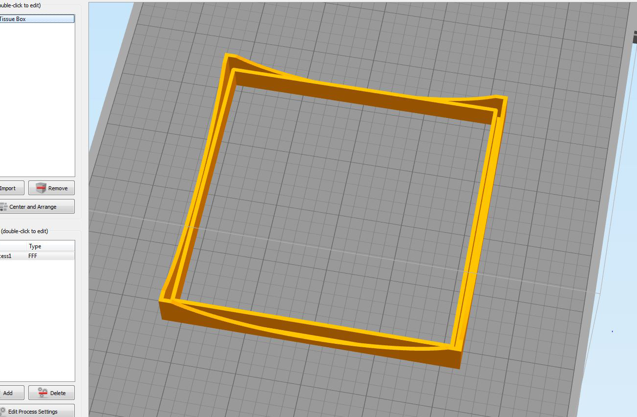

I said that if i saw another weird slice I would try to capture it, so here it is - I'm including the factory file and the fff file below if anyone else wants to take a shot at this thing, along with the original Rhino .stl file.
My first step is always to check for design issues, but Rhino shows no naked edges or non-manifold edges anywhere. What I discovered about how S3D v3 sliced it:
(475.36 KiB) Downloaded 107 times

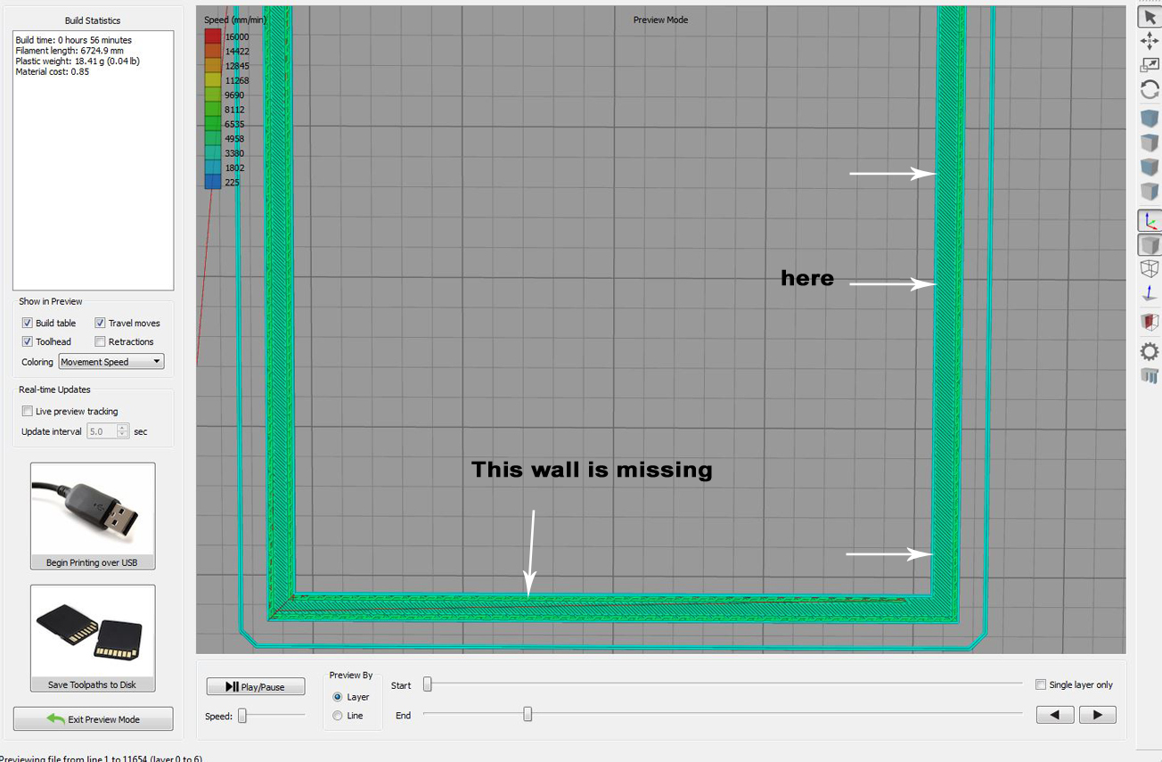

First few layers are okay and in keeping with the design. At Layers 5 and 6, part of a wall line is omitted, leaving a break in the wall. (I would have thought that maybe the wall had gotten too thin at that point, BUT it started printing the line again on Layer 7, just the way it was supposed to, so it's not that.)
(489.42 KiB) Downloaded 107 times

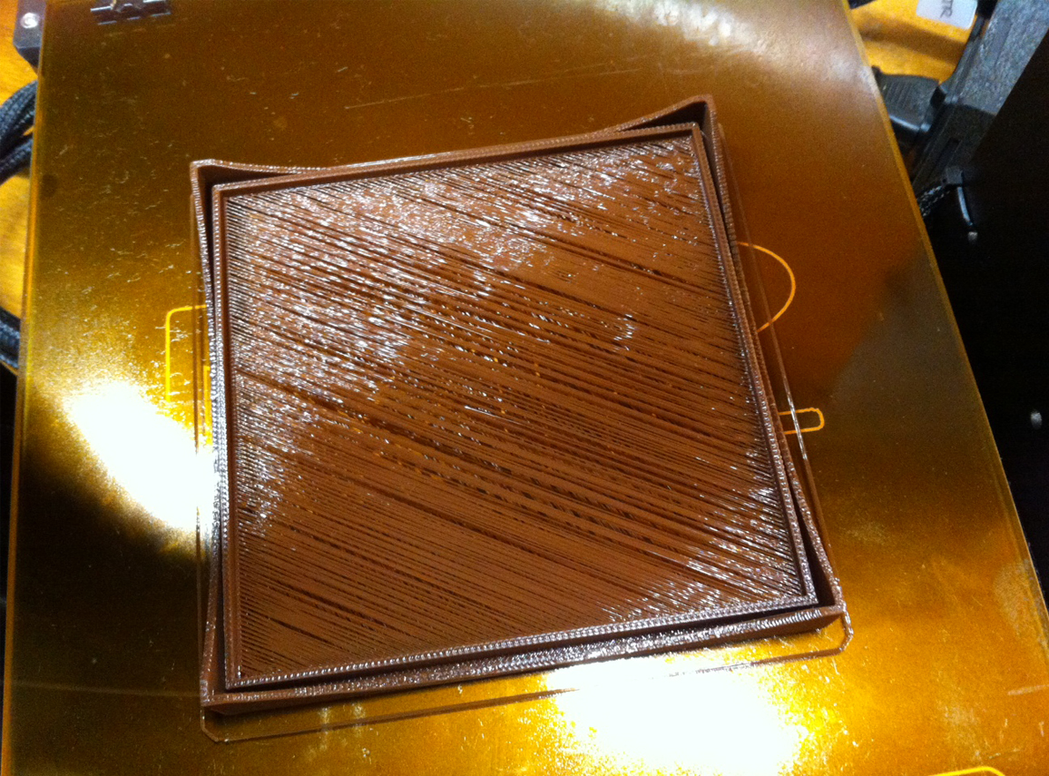

At Layer 9, S3D Bridged the entire span with a layer one filament thick.
(697.32 KiB) Downloaded 107 times
Subsequent layers printed correctly, until Layer 29 or 30, when it bridged again in the other direction.
Then it finished the print correctly.
Here's what it did. (I am absolutely floored by the fact that the M2 could handle that unbelievable slice job!):
bridging record.jpg (969.81 KiB) Viewed 12302 times
I'm going to try rebuilding that file - I can't get S3D to slice it any other way. If someone else who has S3D v3 installed wouldn't mind loading the stl to see how their version slices it, it will at least prove that this version is corrupted, and I can change it out.
