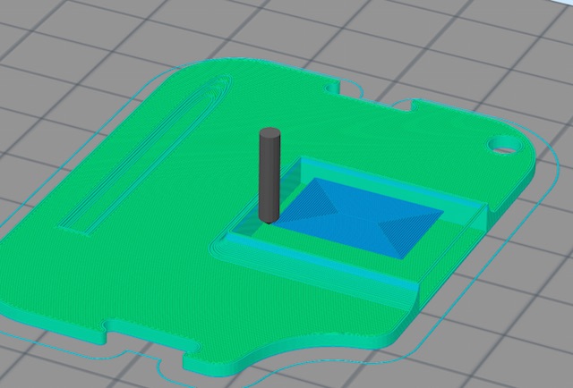

I'm running into that thing where Simplify3D gets confused and starts to do some crazy spiral fill in midair instead of bridging the top of the slot:
I tried all the usual tricks, like juking the object up or down a smidge, changing layer heights, but I can't get it to slice right.

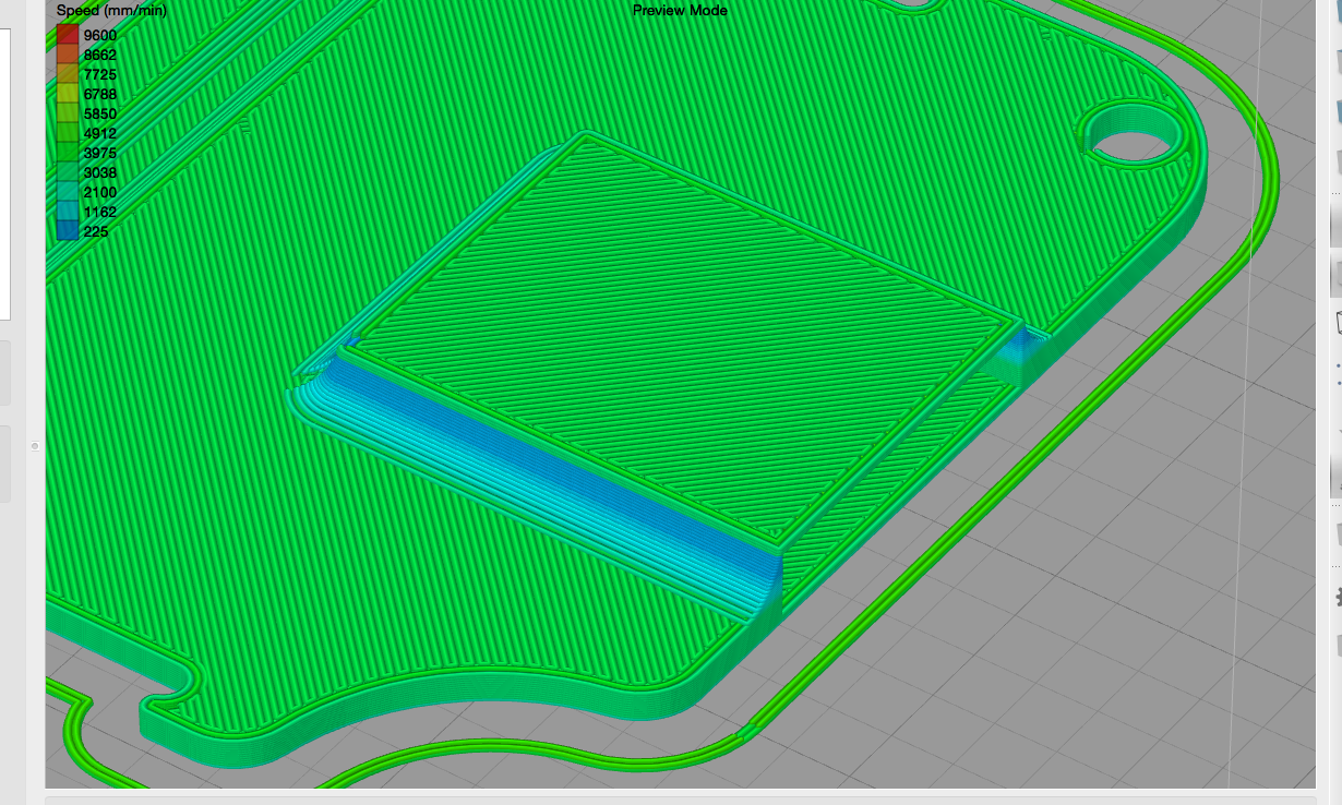

i had no problem with it both with support and without. i tried it multiple times in different layer heights and also did it on two different versions of s3d and sliced great every time.
Screen Shot 2014-12-07 at 2.02.26 PM.png (821.72 KiB) Viewed 17308 times

Jim, your screenshot shows the entire model. Can you try using the slider to get down to the first layer of the top bridge and see if it's a midair spiral, or whether it actually bridged properly?
If it did, can you send me your factory file? :)

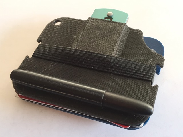

I managed to get Cura to give me a proper slice, and pumped out a trial version. The design is for a plate "wallet" with attachment points for other things I like to have on me. The slot is for a Spyderco Panchenko dog tag folding knife (http://www.spyderco.com/catalog/details.php?product=896) I got off MassDrop, and the groove is to glue in a printed cap for a bullet-style Space Pen (http://www.thingiverse.com/thing:580516).

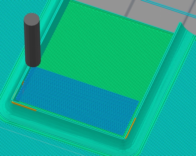

jin, upon further investigation, that first layer you had trouble with was there in the current version of s3d but not in another. i swear i checked it on this version and it was ok but maybe it wasnt and i forgot which version i was using. when i tested it it bridged fine and the way you would think but the strange thing is when it did bridge it seems like it would be the wrong direction. it put a thread across the opening then all the threads run lengthwise attaching each bridge to the thread. im not too sure what you can do about the direction. maybe rotating will help or changing the start point location. i didnt look into it anymore. it seems like you are going to need support on this then dig it out with a screwdriver or something. here is a pic of what i got.
Screen Shot 2014-12-07 at 2.47.50 PM.png (461.87 KiB) Viewed 17304 times

I've seen that transverse bridging before on another model. It's annoying, because the perimeter bridge has a tendency to sag in the middle just enough that it doesn't act as an anchor. Still, better than the kooky spiral.
