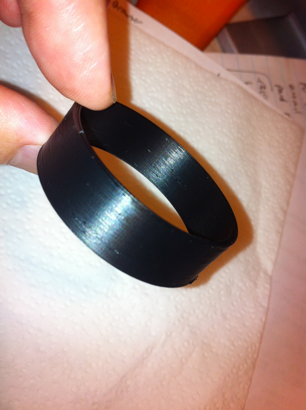

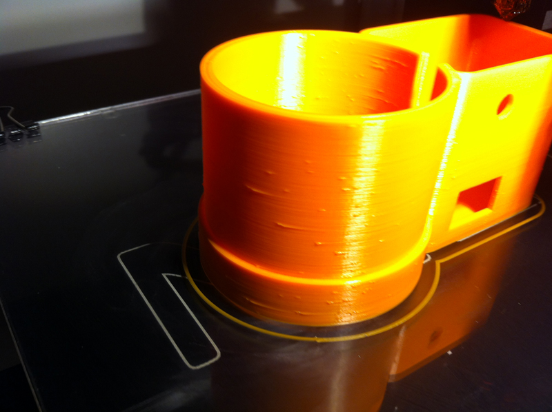

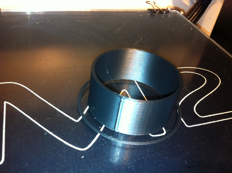

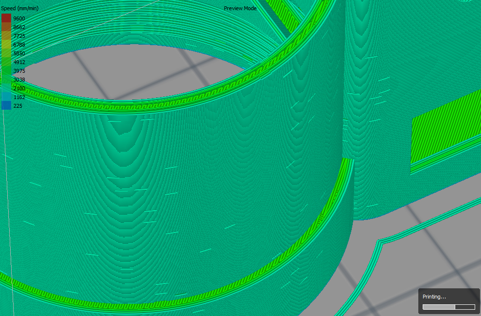

Apparently this is problem that many people using Simplify 3D run into-- which is either warts where the extruder reverses direction when using random start points for the layers, or seams where all the warts are aligned in a row when having the software auto select the start point for optimum speed (which usually has them all located in the same spot on each layer). This one I know should be possible to fix, but damned if I can figure it out. I've played with coasting and wipe distances all day and none of the settings seem to have any effect. Even really big coasting distances like 1.8 mm looks just the same as .7mm. The gaps in the Simplify 3D preview get longer as coasting distances increase, but the warts don't diminish any. I can line up all the warts into a single seam by turning off the randomize feature, or I can disperse them all over the model but just can't get rid of them.
Here's a seam example and a warts example image, along with a print preview showing the gaps where the coasting transitions occur. If I print the orange model and let the software auto-choose the reversal points, it hides all the warts in a crevice and it looks clean. Don't want to rely on that kind of luck though. These are both ABS at 245/90 for the temps

The S3D tool path view shows the gaps where the settings are allowing for extra filament coming out of the extruder---S3D is drawing the gaps but, in effect, is expecting them to be filled. Clearly, the warts line up exactly with those gaps, and show that not only were those gaps filled up by the excess filament coming out after the extrusion stopped, but there was plenty extra coming out to start spilling out over the sides. As long as everything is moving and extruding, the flow of filament is precisely controlled and behaves in a predictable manner. Unfortunately, as soon as the extruder motor stops, a lot of random factors suddenly come into play, as there is still pressure in the nozzle. The pressure will keep the filament flowing out; retraction will stop it, eventually, by relieving the pressure. Meanwhile, the amount of filament still coming out of the nozzle depends on heat, moisture, atmospheric conditions, who knows what.

The filament just came out of a vacuum sealed bag and humidity is currently 43%, so I really don't suspect moisture being an issue. I was actually trying to tweak the settings far enough to cause holes in the model instead of blobs just to find the working range between blob and hole, but can't seem to get that to happen. I've had holes in the past using smaller coast settings, so something else must be interfering. I do have "only retract when crossing open spaces" turned on in the ooze control settings, so there is no retraction happening on the reversals where these blobs are being created. Maybe I'll try turning that off next. Restart distance is set to zero too, so there's another thing to try.
I notice on the cone in the first image that the blob size shrinks as it progresses up the cone layers. Since the print speed diminishes as the diameter of each cone layer shrinks, the blob size can be seen to be effected by print speed. Slower speed produces smaller blobs. My default print speed is 4500, rapids is 9000 and outline underspeed is 50%. That underspeed setting is not clear... is that 50% of full speed or is that a 50% reduction in speed? Of course at 50% it's the same either way, but for changing it to some other value it would be good to know.

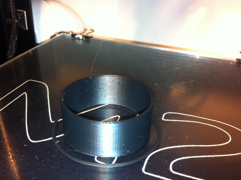

Turns out it was the "only retract when crossing open spaces" setting being checked in ooze control that was causing the problem. When that is checked, the coast and wipe settings have no effect on direction changes within the same layer. Now I'm getting gaps with the 1.8mm coast and can back it off a bit.
