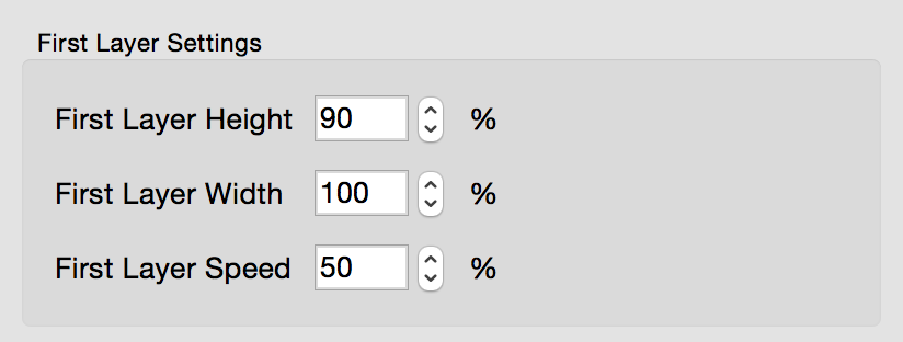

90% seems to be the default in S3D (see attached).
So you're suggesting higher values that what's provided in the default profile? I have noticed I have issues every so often with adhesion, and given I print on blue tape I shouldn't really ever have them... was wondering if just putting down a wider first layer might help. (not to take off topic... adhesion issues have plenty of other threads dedicated to that topic).

yeah 90% has been the default forever. try bumping it up a bit. 125-140% height and a 125% width. you can go higher on the height if your printing at low layer heights like .1 or something like that. then bounce it up to 200%.
