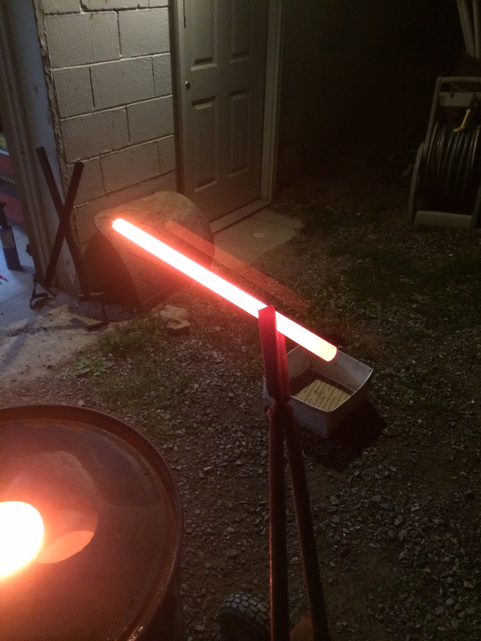

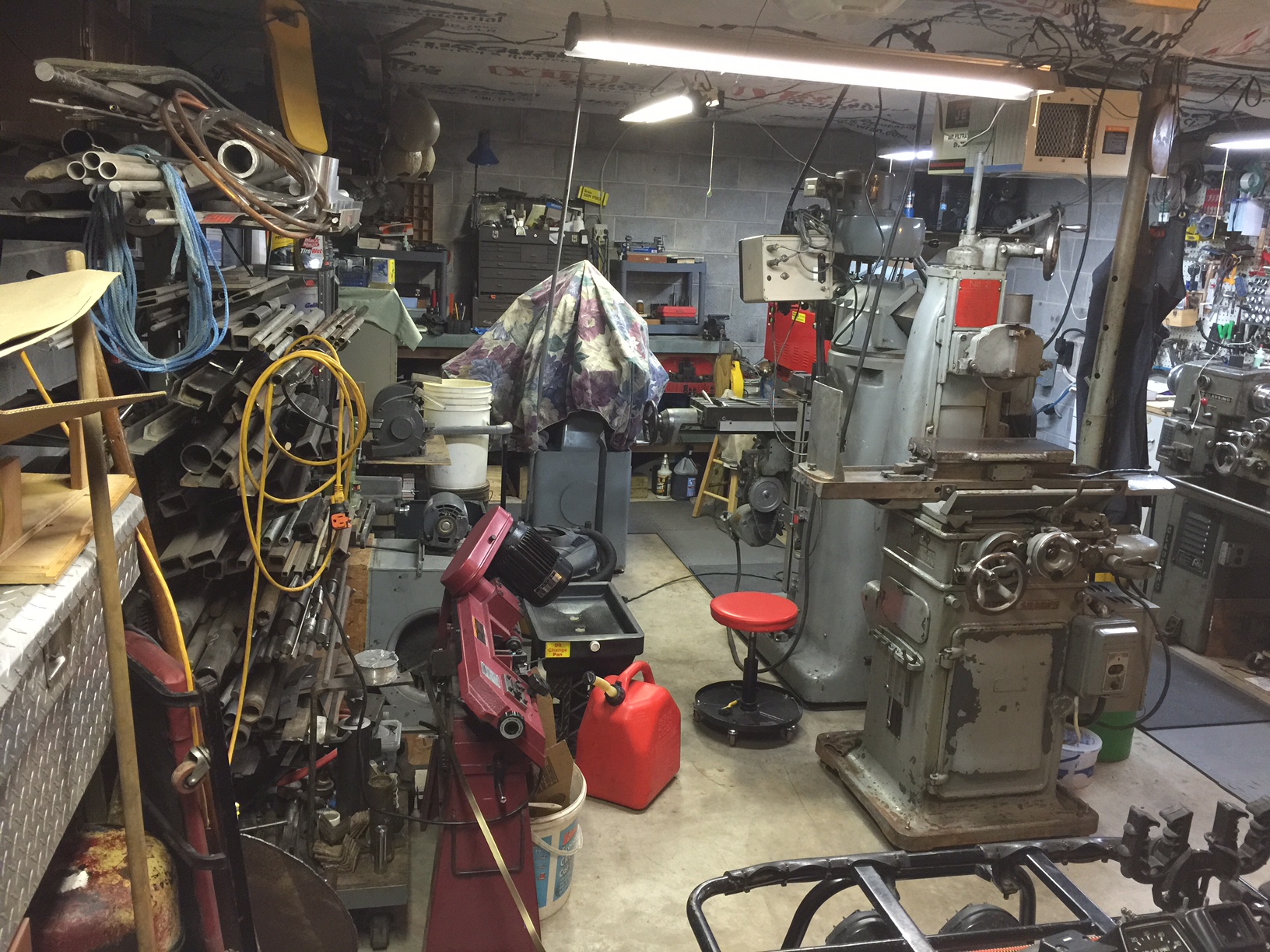

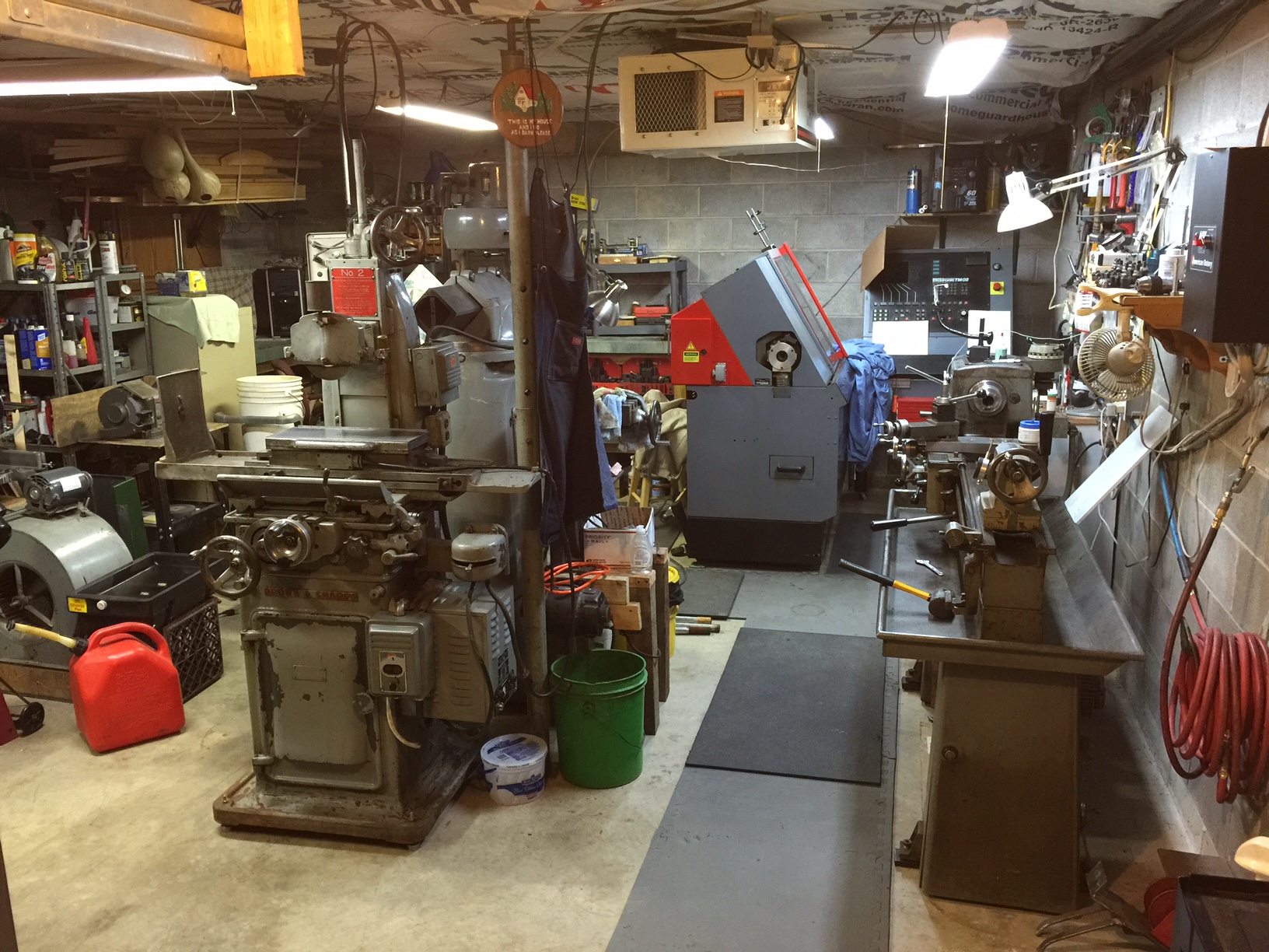

Thanks guy's! I have two seat's of BobCad-Cam v26 and v27 and a seat of Solidworks so I know a thing or two about Cad but I'm looking to scan pieces/parts to be able to make a 3D print to use as a pattern for my foundry. im able to melt anything from aluminum to cast iron and I use an oil based sand called petrobond, its a fine sand that can get very good detail. For me to make a pattern from wood and then get the draft on all the sides right also calcalate in for shrinkage of the metal can take weeks and sometimes a few months with a 3D printer its a matter of hours really. So my main use will be for pattern making and some spar parts for the RC trucks from time to time also just to play with cuz you all make it sound so damn fun! lol
Also if anyone wants something made as far as metal goes in a machine shop let me know ill be happy to help out!
Here are a few pics of my shop.
- This is a piece of graphite gouging rod that I use to flux my pour.
- (314.1 KiB) Downloaded 755 times
- and the other side
- (805.68 KiB) Downloaded 755 times
- one side
- (750.61 KiB) Downloaded 755 times

That's a fine setup!Volcom7114 wrote:a few pics of my shop.
The First Rule of Machine Tools: if you can see the floor, you don't have enough. Works for me... [grin]

ednisley= I wish I could add more machines but I really have everything I need well mostly everything lol I have to keep room for my wheelchair and chips are hell on aired tires on a wheelchair when you have to buy new tires and tubes every 2-3 months as it is :/
