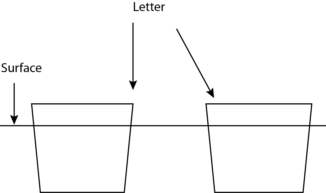

I've got a neighbor who needs to design some fairly easy shapes on the cheap for a business he's trying to get started. Basically he needs slightly wedge shaped 3D text and numbers to use to imprint into a surface to leave a negative impression.
Problem is, he's wanting to do it for a variety of fonts, and I'm not a good enough neighbor to offer to do all of them for him for free. (He's got some big dreams. :lol: )
You guys got any recommendations (or words of warning on which software just wouldn't work) for that kind of thing? His design experience is limited to some Photoshop, several years ago. He needs to understand what is involved in something like this before he screws up his current job to make his fortune on something that he thinks looks really easy. (But isn't).
And insta? Just curiosity......What would you charge for a turn-key operation to print an entire alphabet and number set in a single font, (let's say capitals only), cheapest PLA you got, draft quality, colors don't matter, letters about 5 inches tall, half an inch deep, and with about a 1% to 2% wedge shaped decline in depth? So 36 letters and numbers. It'll take (I'm guessing based on the numbers I did for him) about a third a kg of filament at about 20% infill and 3 surface layers. Took about an hour and a half for 2 numbers on average. (So 27-30 print hours - at a rough guess.)
