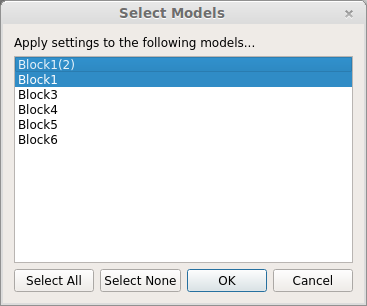

You DO NOT want the Select Models popup to look like this:
In this case, only the first two blocks will print, because the last four do not have any process (FFF) applied to them. Hit the "Select All" button. This is for ONE PROCESS for all SIX MODELS. Don't do what I did before I understood what was going on. I added SIX processes, i guess assuming a process per model, right? NXKNXKNXKNX! Without knowing about the Select Models popup, I printed away. It applied ALL SIX processes to ALL SIX models. After it printed the first layer SIX TIMES at the same height, I looked and said: "Hmmm. THAT'S not optimal...." After I cleaned up the mess and unclogged the nozzle and such, I figured it out.
