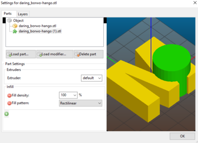

Slic3r will allow you to set arbitrary settings for specified areas. you do this by applying a Mesh Modifier.

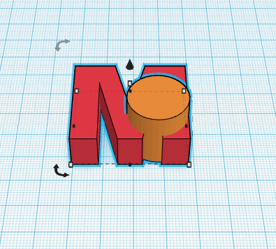

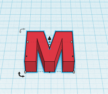

-take your STL into a CAD software

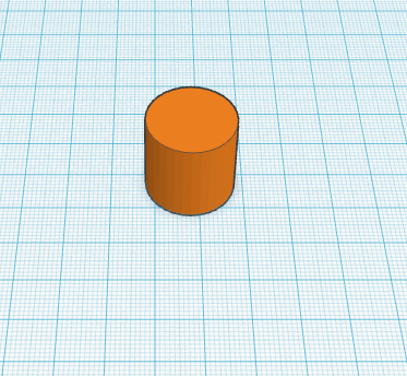

-add an accompaning volume that describes the region that would follow a different set of rules
-in slicer, double click on the STL in question, load the modifier mesh and set the specific settings.
Photo toutorial with TinkerCAD and Slic3r:
Some Sample 3D model
Add the volume that you want to modify
separate out the 3D model to save the modifier mesh

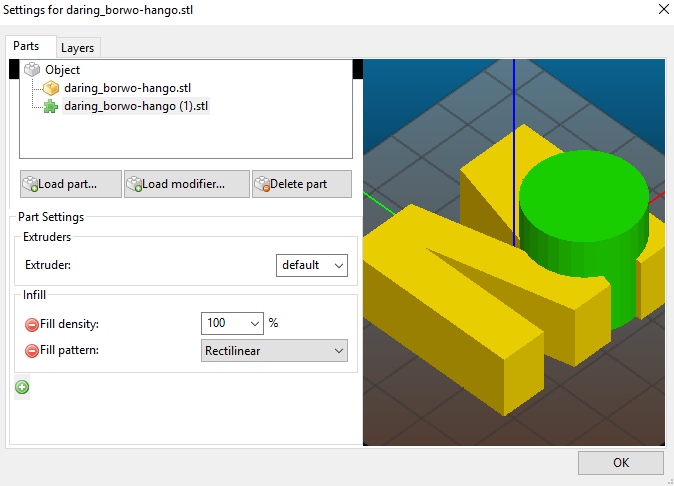

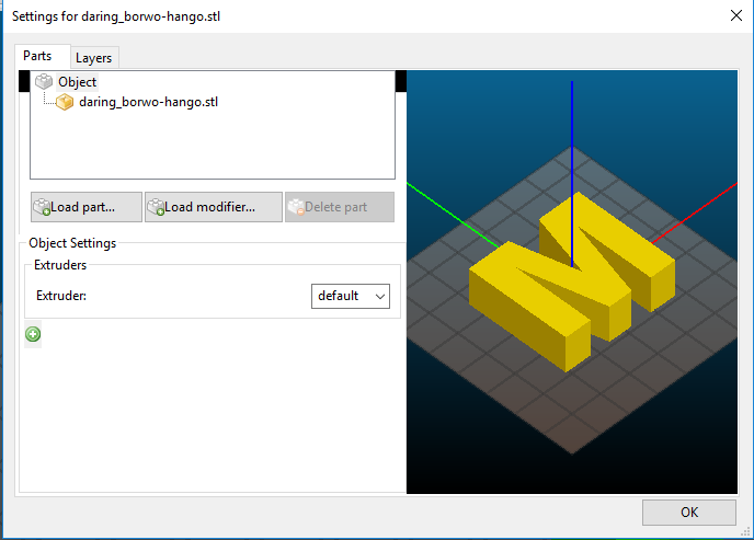

load in Slic3r and double click to get model specific options.
Add Modifier mesh and set the specific settings

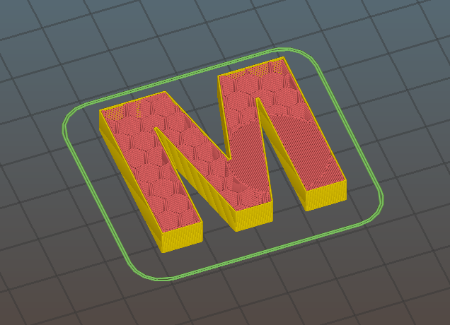

Post by Matt_Sharkey » Sat Apr 23, 2016 2:52 am

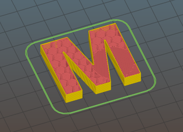

and finally the result:
End result of applying the modifier mesh
