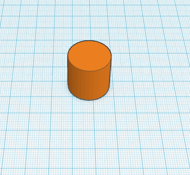

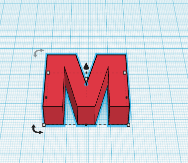

Some Sample 3D model

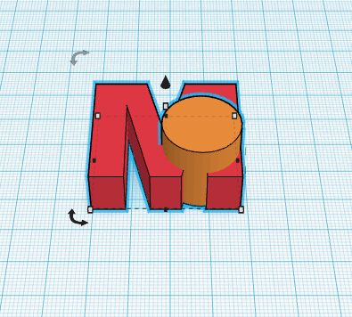

Add the volume that you want to modify
separate out the 3D model to save the modifier mesh

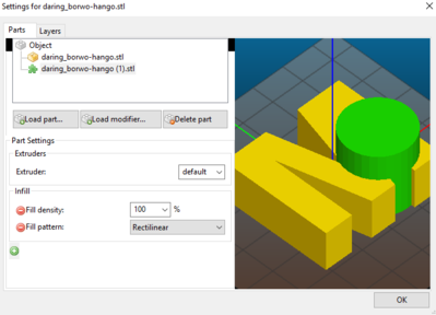

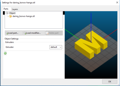

load in Slic3r and double click to get model specific options.
Add Modifier mesh and set the specific settings

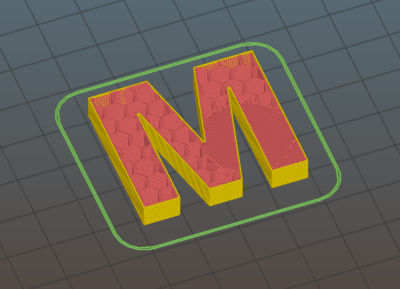

and finally the result:
End result of applying the modifier mesh
