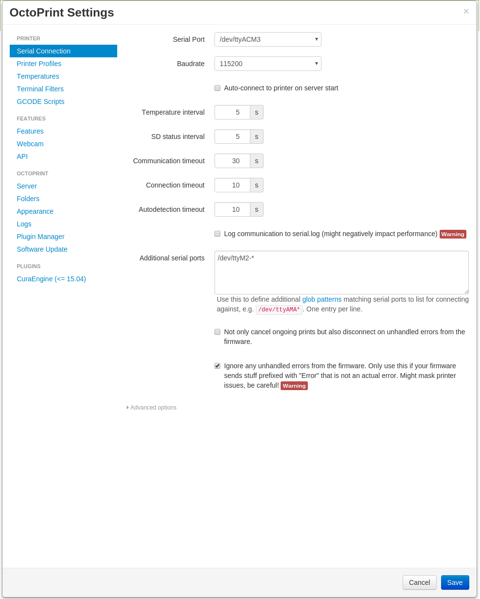

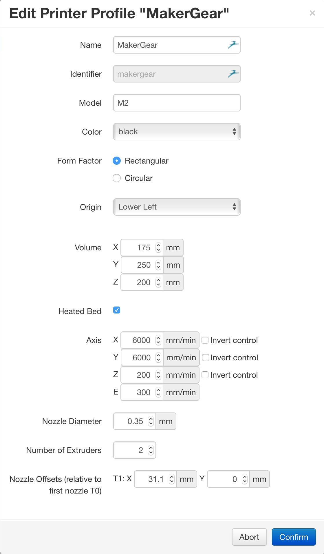

Here's my Octopi Settings screen (I have a dual-extruder machine. If you have one extruder, adjust the last two settings.):

What Jim said, and also set the baud rate 115200 IIRC. cheers, c

Shouldn't the volume be X = 200mm (technically 203), Y=250mm (technically 254), and Z = 200mm (technically 203)? Did you shorten Y to account for the clips? Is that why you have 170mm?petej wrote:Here's my Octopi Settings screen (I have a dual-extruder machine. If you have one extruder, adjust the last two settings.):
I just got a Raspberry Pi 3 - Model B and got Octopi running on it (with a static IP over wireless, which was kind of a pain to figure out but once you know what to do is not hard), and since I removed the clips and am using a Zebra plate I put the above numbers in. Of course I slice the G code with Simplify3D anyway so not sure it matters or not... anyone know?

Yeah if your slicing with s3d or another slicer then bringing your files into octoprint then you dont need any of that. none of those setting that pete posted a pic of are needed. set your baud rate and port then start printing.

For anyone setting up Octoprint for the first time, I suggest increasing the wait time on the communication settings. The communication timeout in one of the older OctoPi images was set very low. It can take nearly 30 seconds in some cases during a power failure or restart to reestablish communication. I believe the default was 5 seconds.
Jimc is right, there are no other settings that would make for bad prints. You might want to try another USB cable if printing is suffering running from you RPi over USB.
