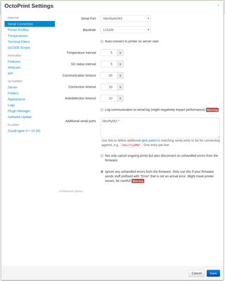

For anyone setting up Octoprint for the first time, I suggest increasing the wait time on the communication settings. The communication timeout in one of the older OctoPi images was set very low. It can take nearly 30 seconds in some cases during a power failure or restart to reestablish communication. I believe the default was 5 seconds.
- Octoprint communications settings
Jimc is right, there are no other settings that would make for bad prints. You might want to try another USB cable if printing is suffering running from you RPi over USB.
