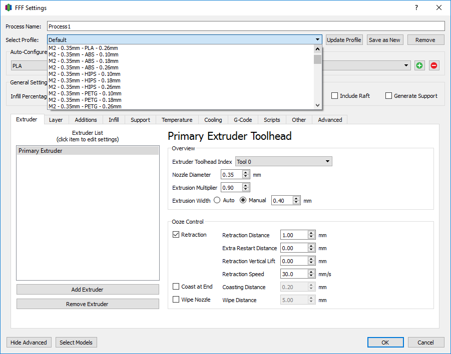

So I got so fed up with Simplify3Ds terrible, abhorrent profile management that I wrote a script that just generates all possible permutations of nozzle, plastic, and layer height I want to run. It's got several things built in:
* sane layer heights per nozzle (0.35 -- .1, .18, .26 / 0.50 -- .18, .24, .30, etc)
* sane temperatures per plastic & nozzle -- fatter nozzles are spec'ed slightly cooler to prevent ooze
* sane speeds per plastic & layer height -- i modelled the "max flow rate" of each plastic (just pulled numbers from my ass). the script automatically generates slower layers when you go fatter layers so the nozzle can keep up.
* proper fan behavior per plastic
* dynamic retraction distance based on plastic and nozzle
* dynamic z-hop based on layer height
It builds all these, then shoves them straight into the registry where S3D keeps its settings. The idea is that, with very little exception, if I need to change something I'll update my script and rebuild my profiles. All my Z_OFFSET stuff I do on the machines directly with Viki & inductive probes.
I'd be happy to share the .reg file if anybody wants to drop my profiles straight in. The code itself is messy and few people have the software to run it (although i'd be happy to github it for collaboration ...?). It's written in C#. It generates, I think, 63 separate profiles?

That's the thing -- I can add dual support to the script and generate approximately eleventy shittillion profiles of all possible left/right permutations + nozzle sizes. Machines are WAY faster at that than humans.Jules wrote:Not sure I can use it because of the dual, but I'd like to see it anyway. (Sounds like a pure work of art.)

The .reg will blow away your entire config and replace it with itself...Jules wrote:Me, too...dual and all. (With the teensiest of descriptions on how to load it....never done a .reg file. Does it go straight into the Registry?)
But, yes, you just double-click and go.
