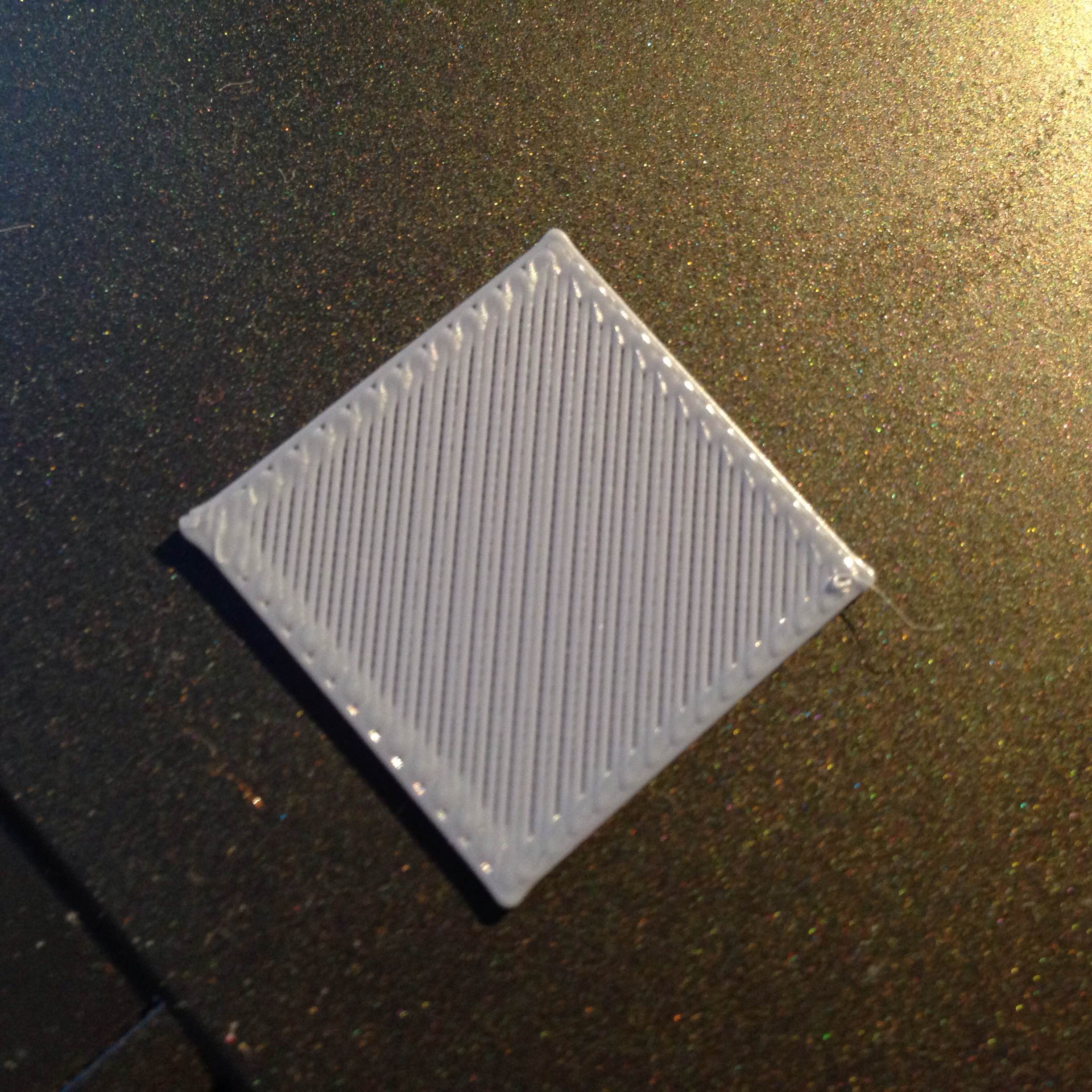

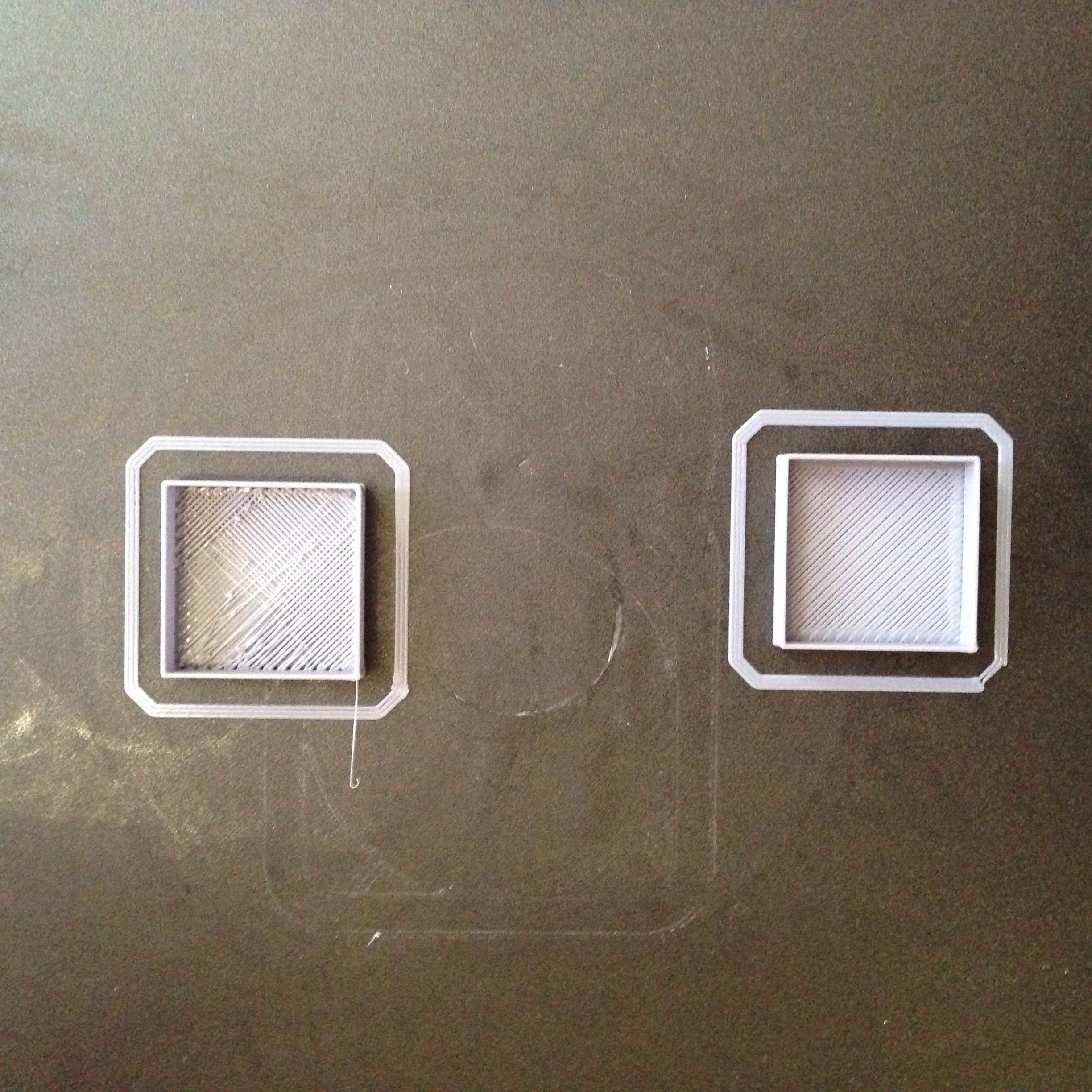

Well, this is weird (I thought PLA was supposed to be easy!).
I'm getting .61-.63mm walls, so I could stand to turn it down just a hair, but it's not in bad shape. My overall width is coming out just a hair undersize; 24.97ish for a 25mm cube, but that isn't too bad either. But the problem is now when I set it to print 3 solid layers to see what the top/bottom layer quality, I'm getting lots of void area - hard to measure, but on the very top of the 3rd layer I'm getting a consistent ~.20mm gap between the extrusions and can even see daylight through the 3 layers in some areas. Any ideas on this one?

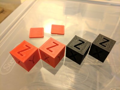

Haven't gotten to infill yet. I'm printing at 220C with a V4, .50mm nozzle, and this is eSun's PLA+ which allegedly likes a bit hotter temps. Here's a picture for an additional ~1000 more words or so. Now that I'm zoomed in it seems I'm getting a little blobby in the corners too..
