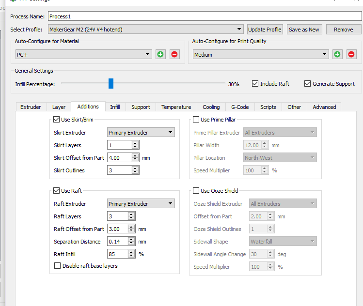

Every time I use one the top layer of the raft breaks apart and sticks to the bottom of the part.
Here are my setting I'm pretty sure they are the default.
I'm using .2mm layers.

Rafts are generally pretty useless. What do you need a raft for?
Usually a 1-layer brim is better, as it does not add to the dimensions of the part, and it's pretty easy to trim off.

Try increasing your separation distance. Do it in small increments until you find the distance that works for you. I was having the same problem and increased it to 0.18mm, worked for me. I increased it by 0.02 each time until I found the sweet spot.
