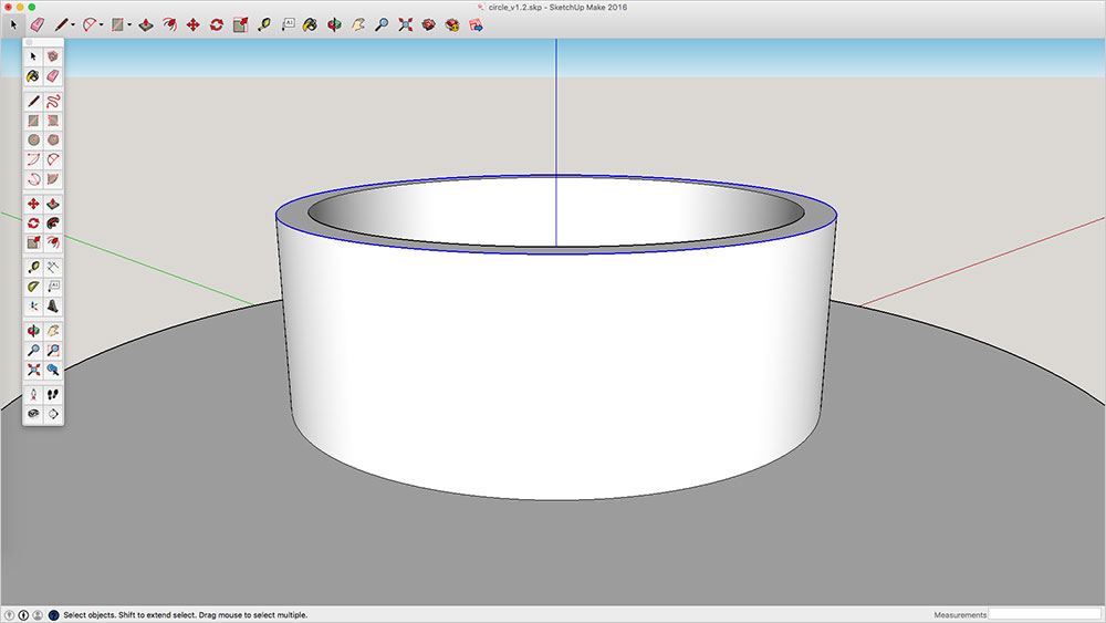

In the image below, I would like to round the corner (selected blue circle shows corner I need to round). I have tried using this tutorial but without success.
https://www.youtube.com/watch?v=OmY4ozUo8uU
Any advice on how to round this corner would be greatly appreciated.
Thank you.

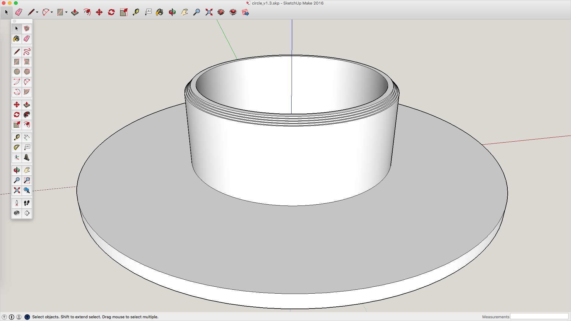

I was able to figure out a simple way to round the corner of the circle. I used the Offset and Push/Pull to create five steps, this ended up rounding the corner.

For your part here above, Fusion, along with most CAD tools, provides a Fillet tool which will round corners with a single operation.
