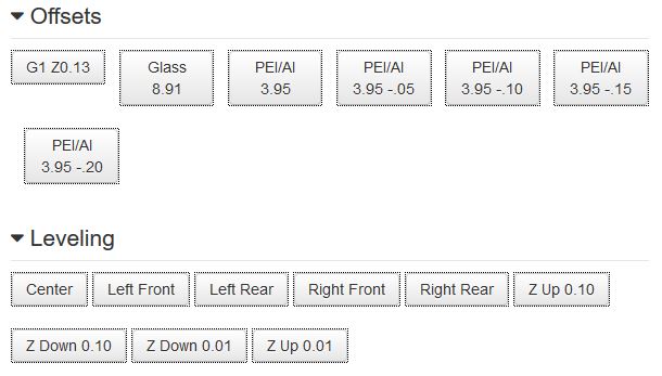

Been putting the Custom Control plug for Octoprint to use lately. I have a Rev E machine in an enclosure in the garage, so using the Quick Start to level the bed was a bit of the pain as I had to haul the laptop out there, unplug the PI, etc ...
So today I decided to add a section of Custom Controls for bed leveling within Octoprint.
First off, I have set Z-Offsets I use for my different beds, and I set my Z height by running the Z-Axis up to -.13 (.005") and dropping the nozzle down onto the shim stock. FWIW, in the heated enclosure I have to set a significantly larger gap, as thermal expansion of all the components matters.
So here's my custom control section:
With "Center" I set my initial height, and also use that as the starting point for leveling. For leveling I'll use the same .005" shim that comes with the RevE machine. I use the Z-UP and DOWN controls until I JUST feel drag, basically like in the quick start application. I then use the 4 corner positions to adjust the bed. Before any movement the buttons drop the bed by 1mm and then raise it back up at the end to prevent dragging.
Did my first leveling with this and it worked great.
Here are the scripts I have behind the buttons. I have a dual, so single owners can tweak the X-values of the moves.
Center:

Z Up 0.10:
G91
G1 Z-0.10
Z Down 0.01:
G91
G1 Z0.01

Since a bed swap usually corresponds with a material change, I pull the old material and let the nozzle cool. Once it's close to room temp I will set the Z-Offset which I now do with custom controls in Octoprint (you can see the buttons above).
A typical script for a button is:

I have some additional offset buttons with small offset adjustments so I can dial in the first layer thickness if needed.
