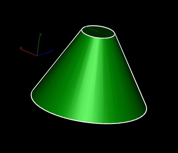

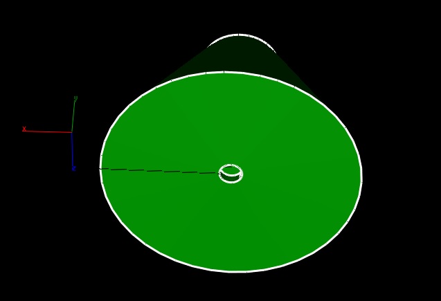

I do not know if I can post pictures or not, I have not been on here for a while. This is of a simple cone I printed for my rotary attachment that goes with my Galvo Fiber Laser. ViaCad also has programs for $1200 or more for the pro's who need advanced features.
