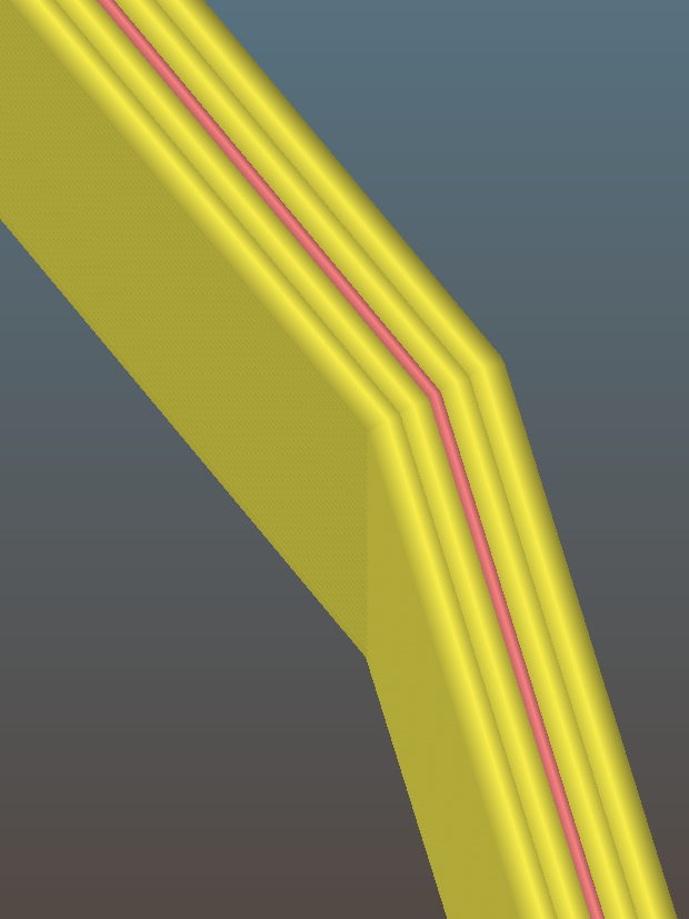

Basically, you tell it what thread width you want and it'll fiddle the filament speed to match; whether the result actually prints isn't guaranteed. You generally want a thread width a bit wider than the nozzle diameter, say 0.40 mm with a 0.35 mm nozzle, to let the nozzle rim compress the molten plastic against the previous layer.
Slic3r sometimes tries to insert a hair-thin infill thread between the perimeters of a two-thread wall, which works terribly with PETG. I managed to tamp it down with a 1.9 × 0.40 mm wall: just under two thread widths.
Always preview the G-Code to avoid surprises!
Thin infill between 0.15 mm perimeter threads
