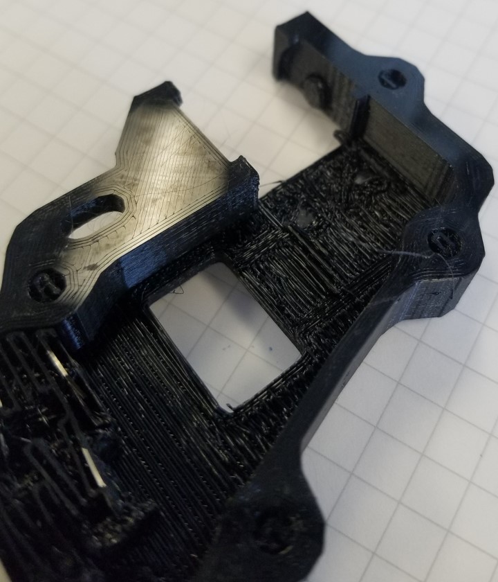

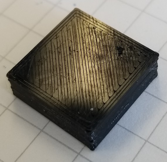

Hi everyone,
I'm running into a problem which I haven't experienced before and which has me a bit baffled. After measuring actual filament diameter and calibrating the extruder by printing a single outline box and calculating the extrusion multiplier (rinse and repeat until specified width matches extruded wall thickness), I get the correct single wall thickness, but significant underfill on top and bottom layers. The pictures below should illustrate my situation (bottom fill only).
These are the results after calibration of single wall width. I usually calibrate single wall width and then print the box with a single bottom (and sometimes top, with ~30% honeycomb infill) layer to make sure the fill is behaving.
I'm using simplify3d 4.0.1. So far I have only come close to closing these gaps by increasing the extrusion multiplier to ~1.25, which gives me a single wall thickness of ~.65mm using a .35mm nozzle. Picture below shows the bottom fill of a test box - most of the bottom layer broke off since it adhered so well to the bed, but you can see the fill density with the higher extrusion multiplier.
I'm aiming for .45mm to .5mm single wall thickness, but so far haven't been able to get there and get the top and bottom fill to cooperate. Honeycomb infill doesn't seem to be affected.
I seem to be doing something wrong, but I can't put my finger on it. Maybe I should note that I'm assuming the extrusion multiplier or other slicer settings are the root of this problem, but I'm open to other suggestions.

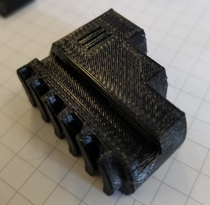

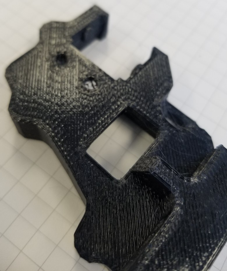

Time for some updates to this and some clarifying pictures.
I was able to run through all the suggestions so far. These have been helpful and have resolved a lot of the issue - but not quite all of it.
This is the part that caused me to stop and recalibrate. It has sparse fill on the top and bottom, as previously discussed. After initial recalibration I got the test prints in the OP.

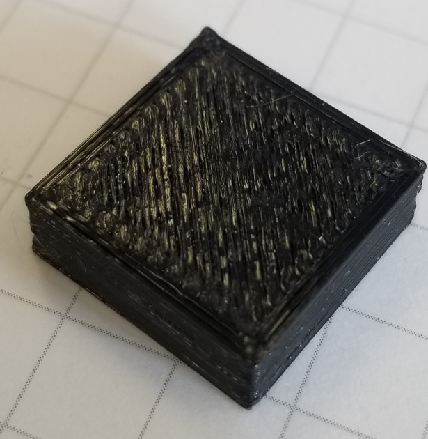

After running through Ed's suggestions I got some improvement in both top and bottom surfaces. I didn't take pictures of the thin-wall box because there's not much to see, but height and extrusion thickness were on the marks of 5mm height and .45mm thickness with first layer height of .97% and .93 extrusion multiplier (I think - I didn't write down the settings or measurements, although I should have). This is with 3 bottom layers and 3 top layers over 35% hex infill.
In the picture above, a bit of the bottom surface adhered so well to the PEI bed that it broke off the internal layer (right hand corner of the box). This suggests to me that the internal layers are too sparse.

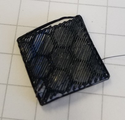

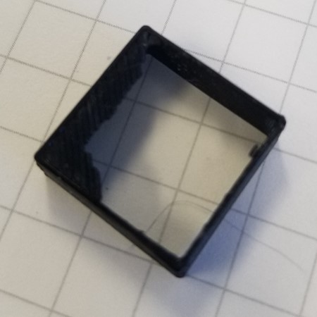

After running airscapes' test print and process I got height and thickness for the 26mm x 26mm x 2mm thin box of 2.06mm height and .406mm thickness with first layer height of 90% and extrusion multiplier of (I think - I don't have it in front of me) .91. No pictures of that since there's no fill. By this point I was tired of boxes, so I printed a spare part to see how the fill turned out:
[bottom picture in next post due to attachment limit]

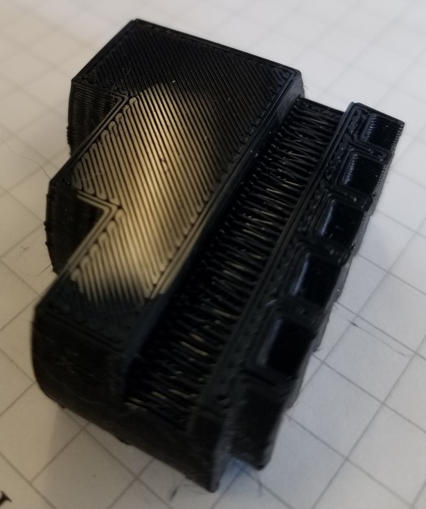

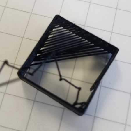

Bottom fill is further improved - probably because of the reduction in first layer height - but not perfect. You can feel the discontinuities between extruded bottom filaments with your fingernail. Top fill is still not so great, with clear gaps between filaments.
At this point I'm not sure what I'm missing. It seems like the fill lines are just spaced too far apart to form a continuous surface. In general this probably isn't a big deal, but it definitely weakens the top and bottom surfaces to the point where surface failures (like the adhesion issue in the test box in the previous post) become a concern.
Paul
