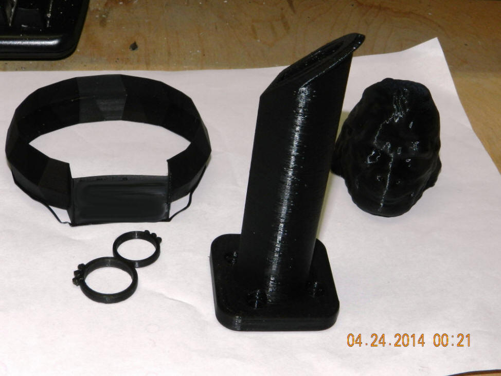

(161.81 KiB) Downloaded 3209 times
Made my first parts today, including the bigfoot head on the SD card that came with my M2.
Tried to print an extended spool off Thingiverse for the M2. Never got this right.
Extended spool file printed off to the side, not centered like my successful builds?
This build failed 5 times: http://www.thingiverse.com/thing:91358
How can you center builds that are centered in S3D, but print off the center of the build table?
Why does this happen?
Long-long journey for me. Reading instructions has never been my strong suit, but with the help
this board supplied, my new M2 is no longer a paper weight.

Spool holder finally came out right:
