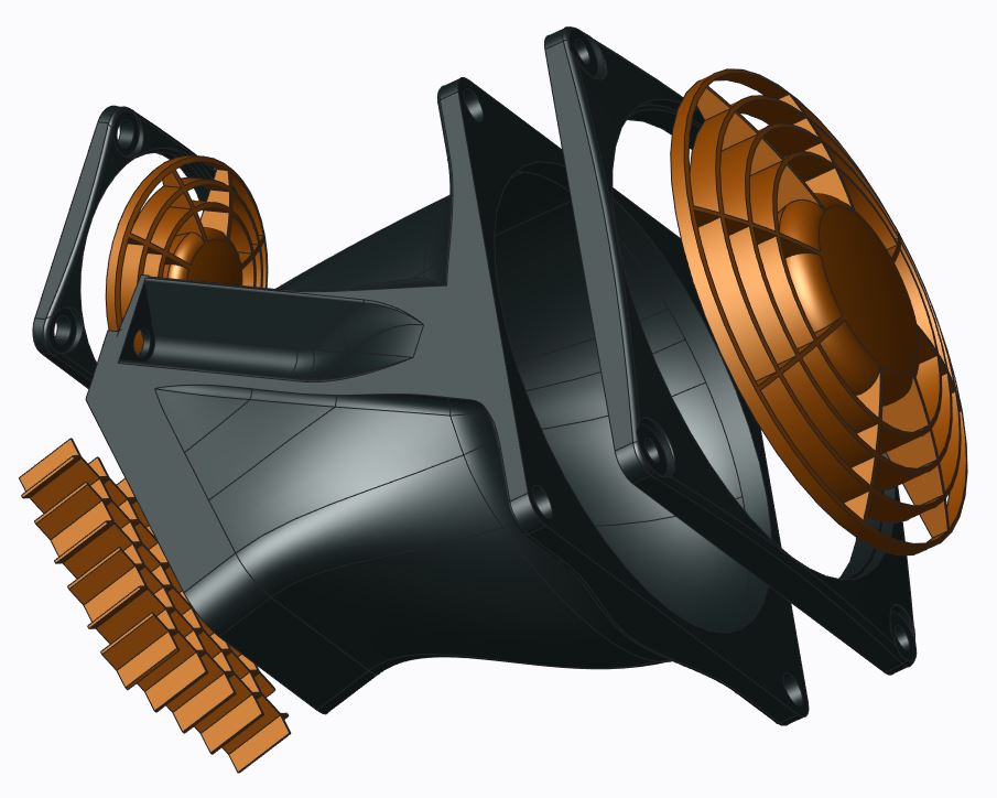

https://grabcad.com/library/makergear-m ... and-duct-1
The duct builds with the 80mm flange on the table. I made everything in PLA with .1mm layers.

Nice! That oughta cool it down! :D

It does, but my main goal was to run the fan slower for less noise.

Nice model. The problem is, it turns out high CFM 80mm fans rely on moving a large volume of air at low pressure to get that CFM, which is the opposite of what you want in a ducted fan.

As I said above, my main goal was to maintain cooling with a lower RPM fan - not to increase CFM.

Love the color scheme. What CAD program are you using?

I use PTC Creo (aka Pro/ENGINEER) via the day job.
