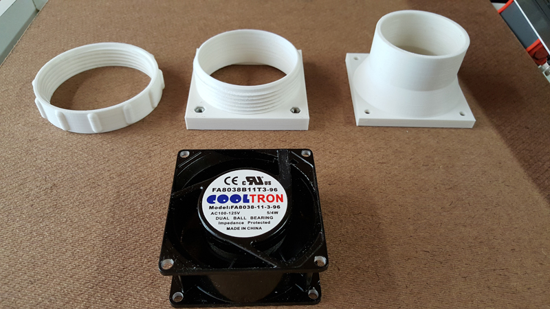

I made this adapter for panel mounting a cooling fan in my printer cabinet and figured others might find it useful. It only fits one specific fan, which is this AC fan I got off Amazon:
http://www.amazon.com/AC-Infinity-AXIAL ... ge_o07_s00
Any fan with a 80mm square base should work too though. The bolt length for this specific fan are 50mm. I'm using M5 bolts so had to drill the mount holes a little larger in the fan.
The purpose of the adapter is to give you a clean mount at the back of your cabinet and then transition the airflow into a fitting that standard 2" PVC pipe will fit into. You can also clamp 3" flex hose around the outside of the output pipe, which is what I'm doing.

Here's the STL files. The two pieces that attach to the fan have to be printed on a raft if you're using ABS, otherwise they warp big time no matter what your hold-down method is due to only contacting the plate around the edges.

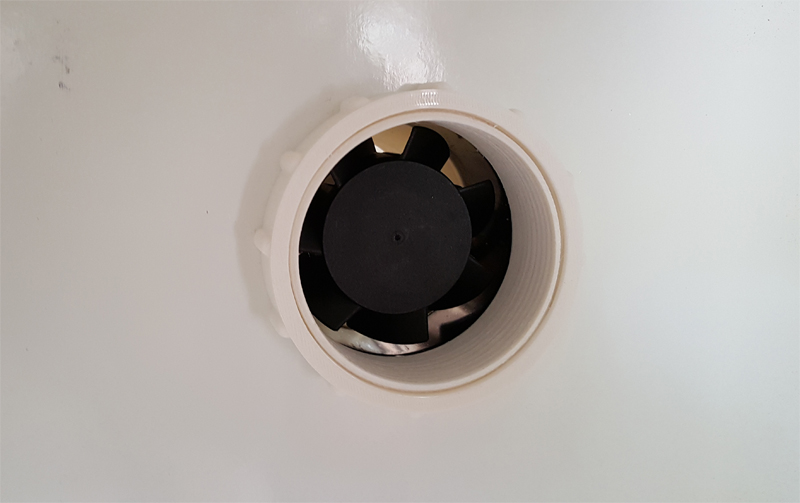

Here's a couple more useful pieces for making a cabinet ventilation system. A 3" flex hose will fit perfectly on the outside of the fan exhaust, which is much easier to route than PVC so that's what I'm using. So I made a matching panel mount fitting that uses the same hose/pvc connector and same threads/nut for connecting the vent hose to the outside exhaust port. I've got five of these mounted in a window box as seen below, with a piece of silk screen over the hole to keep bugs from coming in. I also made a rubber cap that is intended to be printed with ninjaflex or similar TPU so that you can plug the exhaust ports when not in use to keep cold air from coming in during the winter.

Having five printers packed into my small office and a low tolerance for stinky ABS fumes, it's a must-have for me. I think the heat would get pretty bad too if they just vented into the room with all five of them going. With the vent system I can't smell even a trace of ABS while printing.

It turns out that super fine silk screen blocks the air flow too much, so I'm switching it to window screen.
