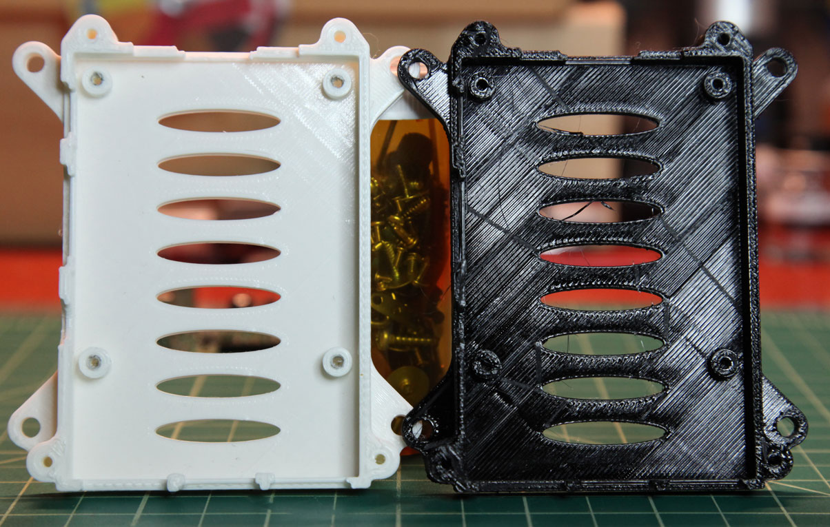

  3. Here's a RaspberryPi case from Thingiverse I printed nicely in MG white PLA vs the eSun (I realize the contrast on the PLA makes it difficult to see the layers). Dimensionally, it fits the Pi nicely just like the PLA print (and I understand for dimensional stability, you really can't beat PLA). Any tips to help with the cleanliness?

Matt's right - with PETG it's all about dialing in the settings correctly, and going a little bit underextruding. Make the gap .01 mm less than what you test it to be with the calibration square. Reduce your extrusion multiplier by a little bit. Put a jump on the travel movements to keep from scraping it.
But also.....don't expect it to look like PLA. It's shinier, and in the opaque PETGs you will sometimes see marks in it from the travel movements. That's just the nature of PETG. (I prefer PLA for parts that don't require structural strength....it has a nicer finish on flat surfaces. PETG looks better on the sides if it's dialed in correctly, but you can always see a "texture" on flat surfaces when the light hits it.)
Oh, also be sure you adjusted your Filament Drive Screw tension for the PETG, it's a little bit different than PLA.
Your print doesn't look bad at all....I don't see a lot of stringing. (Heck of a lot better than my first shot at it!) :lol:

Yep...no worries there. My primary reason for PETG right now is for durability. I'm not worried about how it looks...I just want to dial in a durable filament that can stand up to heat and won't deteriorate in moderate humidity.

I've already prepared myself for that. My primary reason for delving into PETG is for replacement M2 parts. I'm not worried if they're pretty...I just want them to not melt :).

Jules wrote:Your print doesn't look bad at all....I don't see a lot of stringing. (Heck of a lot better than my first shot at it!) :lol:
Thanks!. I'm overall pleased with it. Functionally it's just what I needed. Aesthetically, looking for pointers from you guys and gals :)
