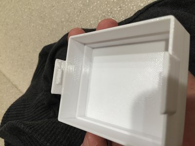

I understand how the new system works, and what steps have to be taken to adjust for specific problems in both the old system and the new one, and I know what the differences are. I can probably even tell you how to adjust the nozzle to get rid of the blobs with your Rev. E, but it's going to involve G-Code modifications, and I wasn't sure if you wanted to go that far. You will have to fine tune the Starting Height gap using G-Code, because the Z-Offset in S3D only works in relatively large increments (0.1 mm) for the Rev. E machines, and you will need to continue the adjustment of it using a much smaller increment. (0.02 -0.04 mm) That's why I tell Rev. E users not to bother with the S3D Z-Offset Adjustment - it can't be fine-tuned to the level that it needs to be. For most filaments, they are fine with the Starting Height set in the beginning. PETG takes a little extra work.
What you need to do to avoid the little threads that are created on the nozzle is "air-print" the PETG just a little. Since your initial problem was with incorrect tension and fill percentages, and you changed the Starting Height (aka: Z-Gap). You needed to get past that before the threads became a problem. Do not adjust your gap again - it's as close as you are going to be able to physically get it, and the print looks good with the exception of picking up threads.

The threads are formed when the very tip of the nozzle just barely brushes against the top of the filament that has already been laid down. It sticks to itself very readily. (You can see it if you get down at eye level and watch the tip of the nozzle while it prints. For PETG, you should be able to see a fine line of air between the nozzle and the previous layer.) So you need to increase the gap size by from about 0.02 mm to 0.04 mm. Start with 0.02 mm, give it a try, and if it's not enough, add another 0.02 mm to the gap.
