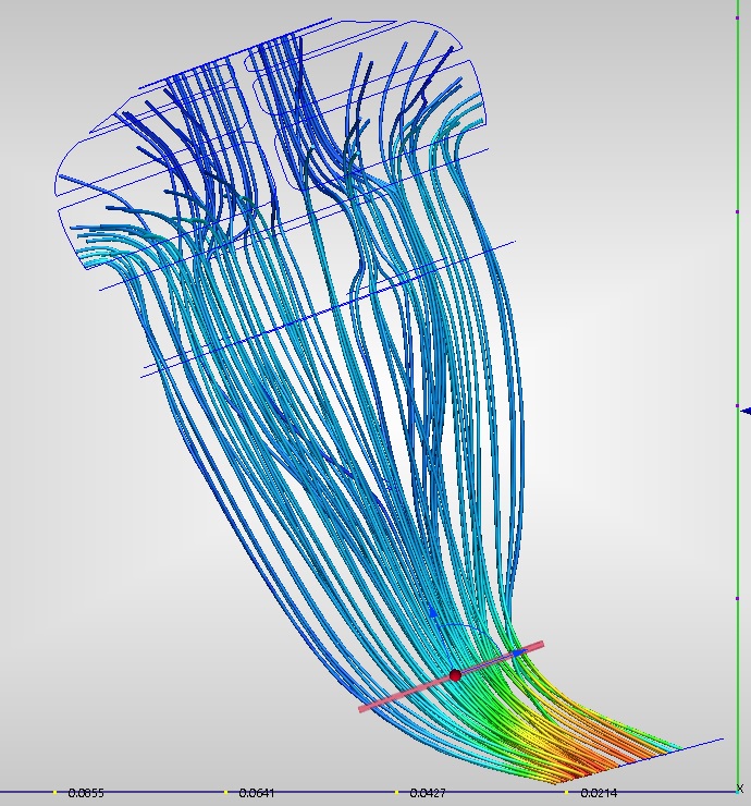

Thanks Insta. For grins and giggles I ran a simple CFD analysis on the duct assuming a 0.1" H2O static pressure at the inlet. Distribution looks nice and it seems the tongue in the center nudges air to the perimeter on either side which is what I was hoping would occur. The simulation does not take turbulence from the fan into account so everything looks nice and uniform. I will likely add a .25" straightener in the section of the throat just below the flange face to help reduce turbulence.

CFD of the fan guard looks promising as well. Very little pressure drop (<0.09" H2O) and good distribution. Knock off a few of the sharp, interior downstream edges and it should be in good shape.
Velocity vectors and pressure gradient
Trace paths
