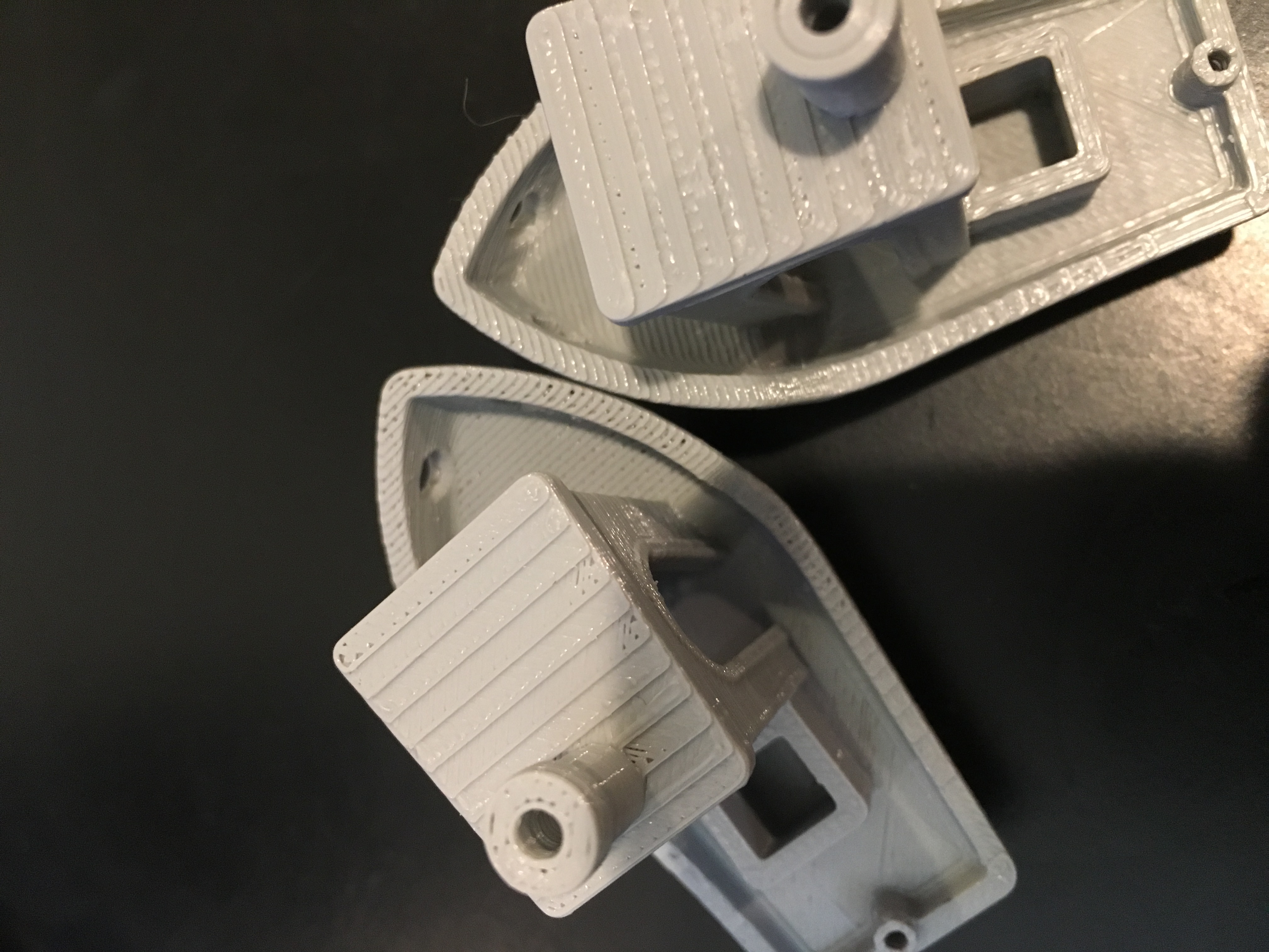

I'm having a hard time balancing the extrusion multi. In Slic3r I found the multi to be 0.99. I applied this to S3D and got a good benchy, but a bit over stuffed. so I calibrated and found it was overextruding. So I found S3D's multi to be 0.92.
Now is the frustrating part. I need a multi of 0.92 to get my 0.4mm single wall cube as desired. but then when I print anything with solid infill, it's too anemic and need more multi! WHATS GOING ON?!?!?

If I want a solid part in S3D, I set the bottom layers to 9999. Works better than 100% infill.

I was referring to top and bottom layers which are solid, I still use infill, but I care less about infill quality...
0.92 multi on left
0.99 multi on right

Look at the Outline Overlap setting on the Infill tab. I think default is 10%. Might want to try increasing that.
