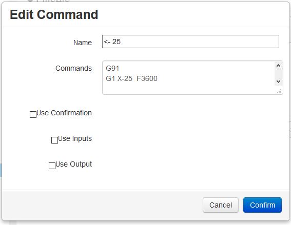

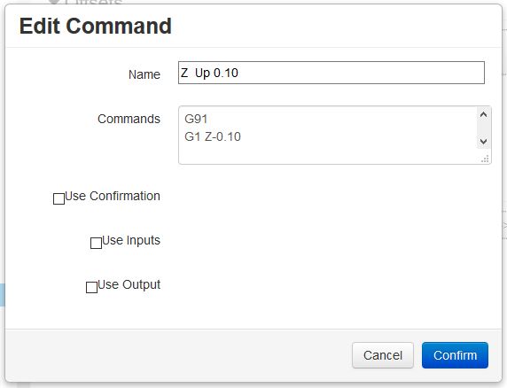

I haven't seen a plugin, but I created custom control buttons I use for leveling the bed.
I can share the details of the scripts later, if you like. There's not much to it.

I would love to get more info on this. Hopefully its something I can figure out.zemlin wrote:I haven't seen a plugin, but I created custom control buttons I use for leveling the bed.
Re: Octoprint and M2 print Bed leveling
Get the Custom Controls Editor plug for Octoprint.
I have a dual extruder, so you might want to tweak the X coordinates - but the leveling screws are all accessible at these points.
I have fixed Z offsets I enter for my various build platforms and I just adjust the hot-end (while cold) with a feeler gauge to get my start height.
