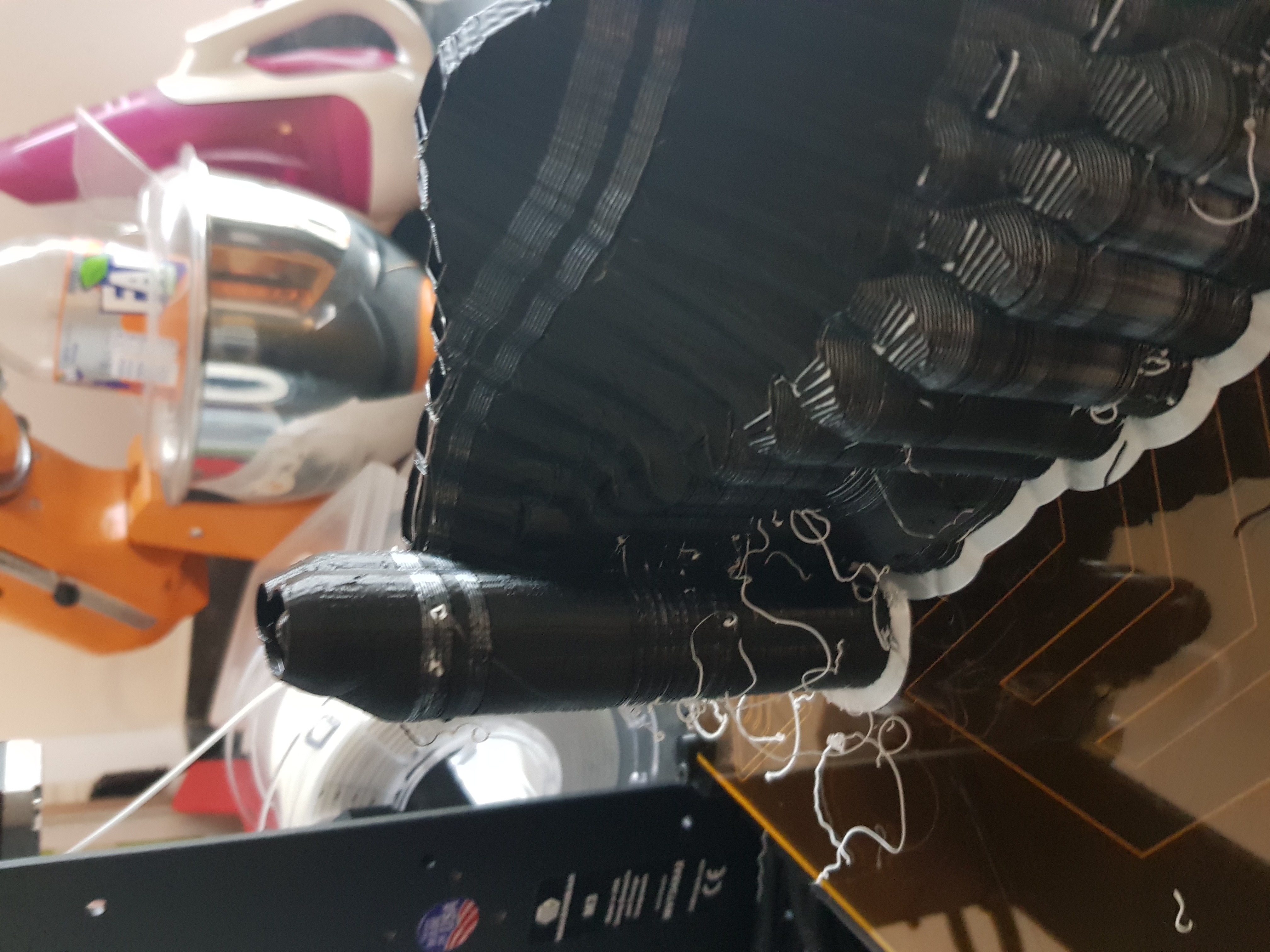

I also think the temperature seetings of this profile are off, polysupport at 225 is not adhering to the bed. or am i doing something wrong? the PLA temp is set to 200 which is also a tad low right?
Re: simplify3d M3 ID polysupport profile error
I tried multiple prints with this profile, but the brim it is printing is simply not adhering, with this settings, not with the polysupport but also not with the standard PLA
I fixed the adherence issues by cleaning the bed with acetone.
But it is still leaking a lot of polysupport. Anyone changed the settings for this profile to something working.

Can’t help with the polysupport issue directly, but you may have the heat too high. You will always have a little ooze, but high heat is what causes dripping. You can probably go up 5-10° on the PLA, but it kinda depends on the PLA.
My main comment is a question. Are you using it as a raft or brim for this model? This model does not look like it needs that feature since it is all rounded corners.
I always print a single perimeter skirt with a 5mm offset to check my print area and prime the nozzle. Sometimes I will use a brim on narrow things that might be knocked over. I almost never use a raft, until there is no good flat on the model to build from.
Just trying to save you a little time and material. You may get tired of printing on plain glass and the issues that go along with it. Switching over to something with some tooth and giving up on glassy print bottoms that no one sees will eliminate some headaches as well.
