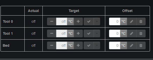

Ok, i found the profile and now i finally got it to work,
it's printing fine, but in octoprint, im assuming the left hottend temp is being displayed, i have no control over the Right Hotend.
Re: Printing with Right head, T1
I'm being Captain Obvious here, but did you set the number of extruders to 2 in the Octoprint printer profile?spatterfree wrote:[...]but in octoprint, im assuming the left hottend temp is being displayed, i have no control over the Right Hotend.
You should see both extruders in the Control tab:
- Posts: 10
- Joined: Tue Feb 06, 2018 3:09 am
no, i didn't, i made a profile for right extruder only.
