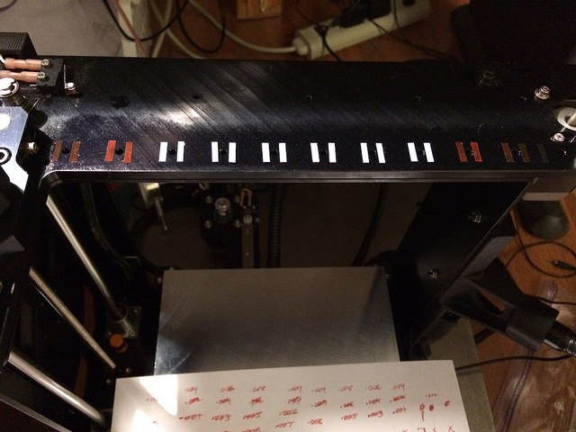

I'm still digging into this in the interest of fixing this once and for all and being able to print edge-to-edge on the first layer. Here's what I've done:
- Set up BLTouch and configured Marlin to sample a 15 x 15 grid
- Modified Marlin so each sample point takes 9 samples, throws out the lowest and highest, and takes the average of the remaining 7
- Let that run for a while, collected data
- Analyzed in Excel to isolate X curvature at each Y position, Y curvature at each X position, and variation of each point from the combination of those two
I mounted the BLTouch off the right side of the second extruder, so it cannot measure X < 57.
These are the measured values (0 is approximately E0 nozzle height; more negative numbers represent bed surface being farther away from the nozzle):
So I've got significant curves on both X and Y axes, each one contributing a little over 0.1mm, for up to 0.23mm variation across the measurable area. X probably gets even worse between 0 and 57.
Over the next day or two I'll do a teardown and clean of both X and Y (maybe debris somehow got under the Y rail?), re-measure, and shim along the lines of what Zemlin did. I'll probably also test with just the borosilicate glass in case some of the error is being introduced by my MIC6 + PEI bed.
