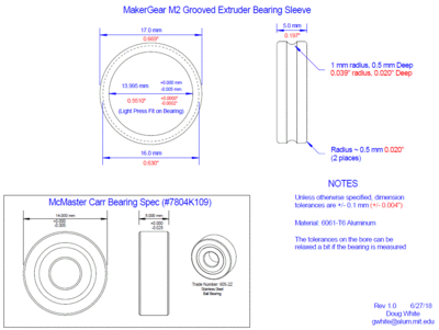

Post by Gwhite » Thu Jun 28, 2018 3:05 am

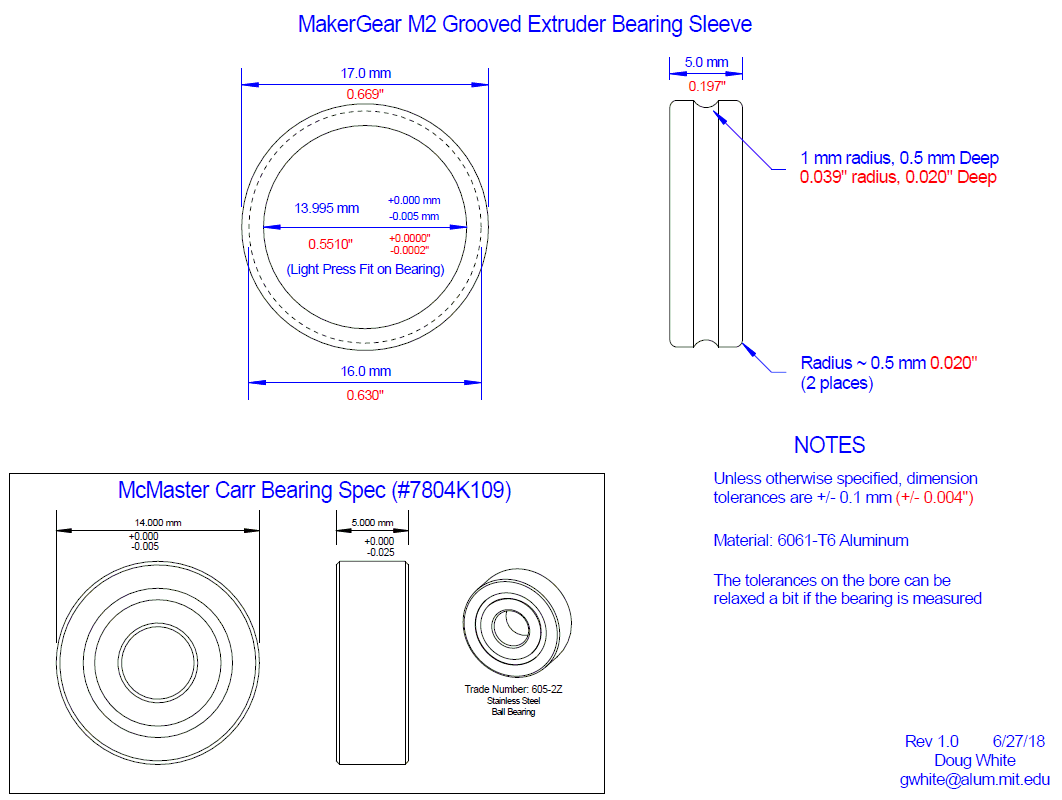

I've attached a drawing of what I have in mind. The press fit over the bearing is tricky. If it's too tight, you may snap the sleeve. If it's too loose, it may expand enough when hot to begin slipping. I made a guess as to what would work, but I can't easily measure stuff that fine anyway, so it's mostly going to be trial & error.

Hey this is great! And I have that bearing sitting in the shipping bag on my desk, have not opened it yet.
I also have the files for the dual spring drive and am using it as originally designed So when I get a chance I will alter it to make room for a bigger bearing as I think if I make the sleeve out of EPA it will need to be bigger than if it was made of metal.. but maybe not! Will keep you posted!

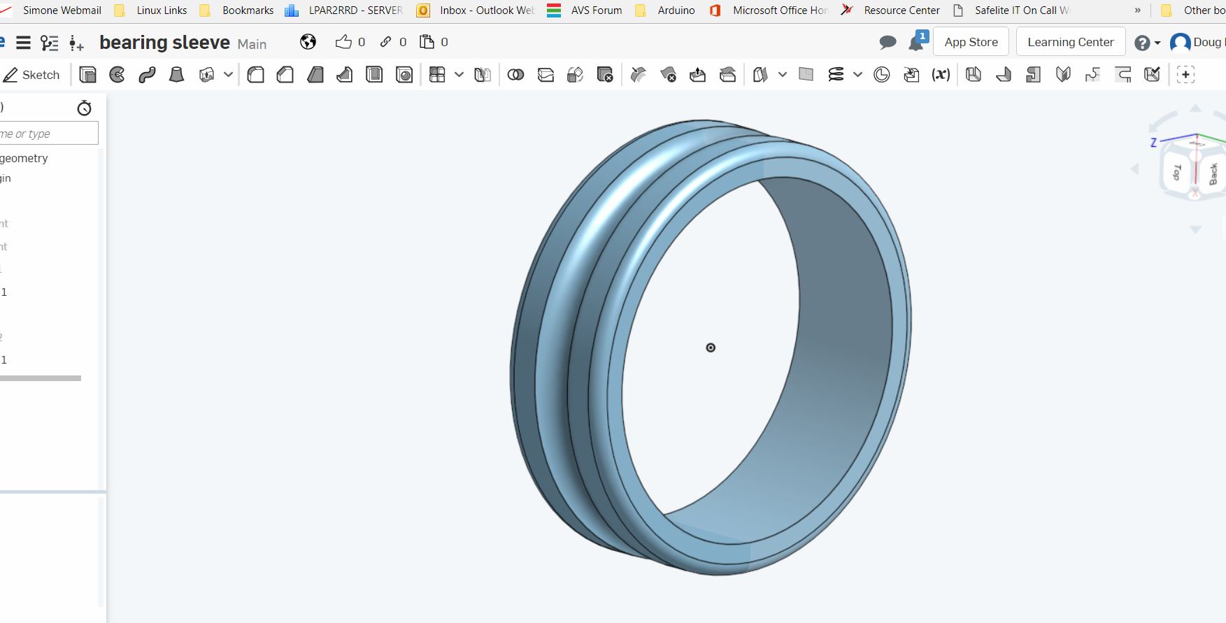

Post by airscapes » Thu Jun 28, 2018 11:14 pm

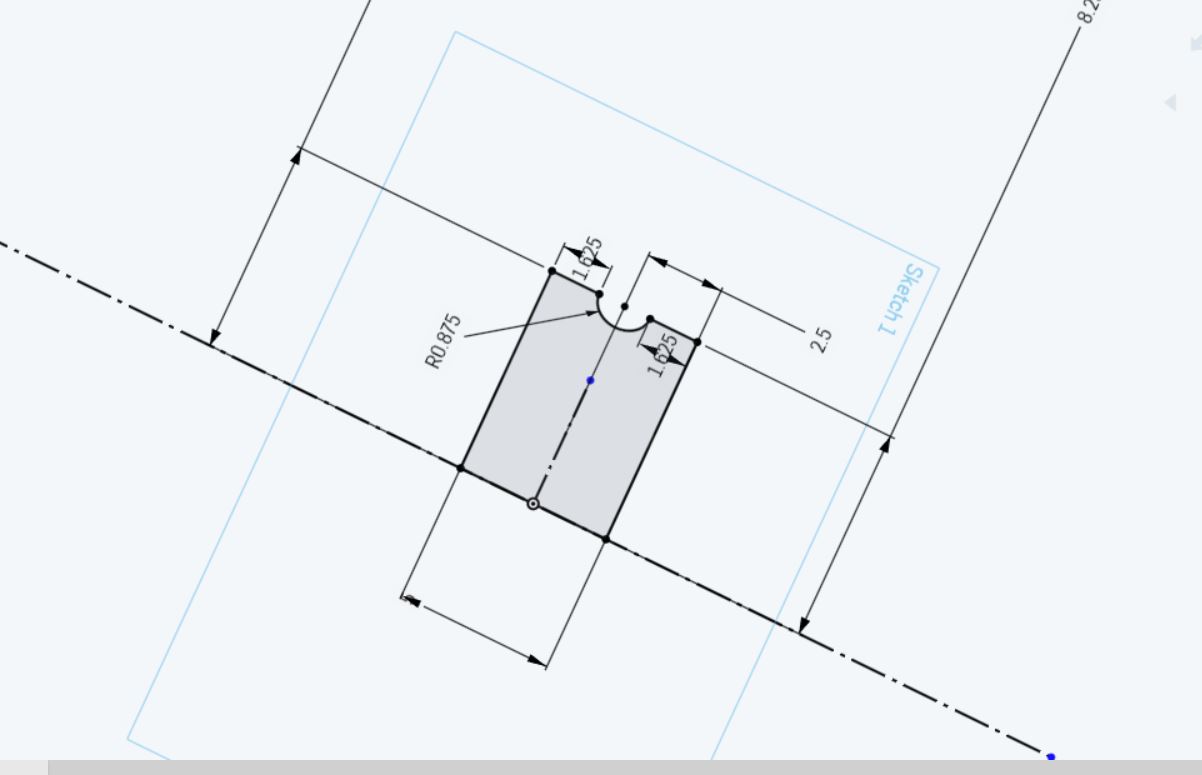

I modeled your drawing and made a few size changes and the bed is heating to print in PLA just to be able to hold it and put filament in the grove etc.. I expanded the grove to 1.75 and .875 deep an overall diameter of 16.5 to compensate for most of the groove depth so the filament is still close enough to the drive gear.. I think I needed to do that.. will know more when I can touch it and slide it in the OME house for fit..

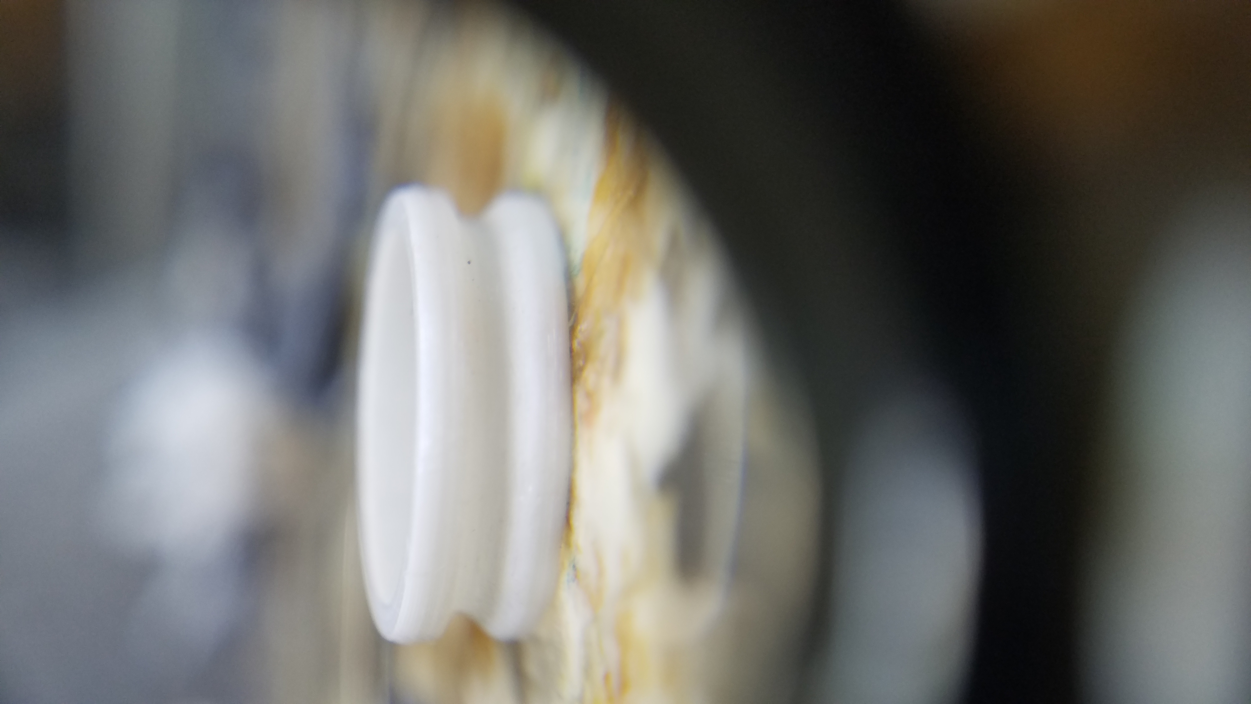

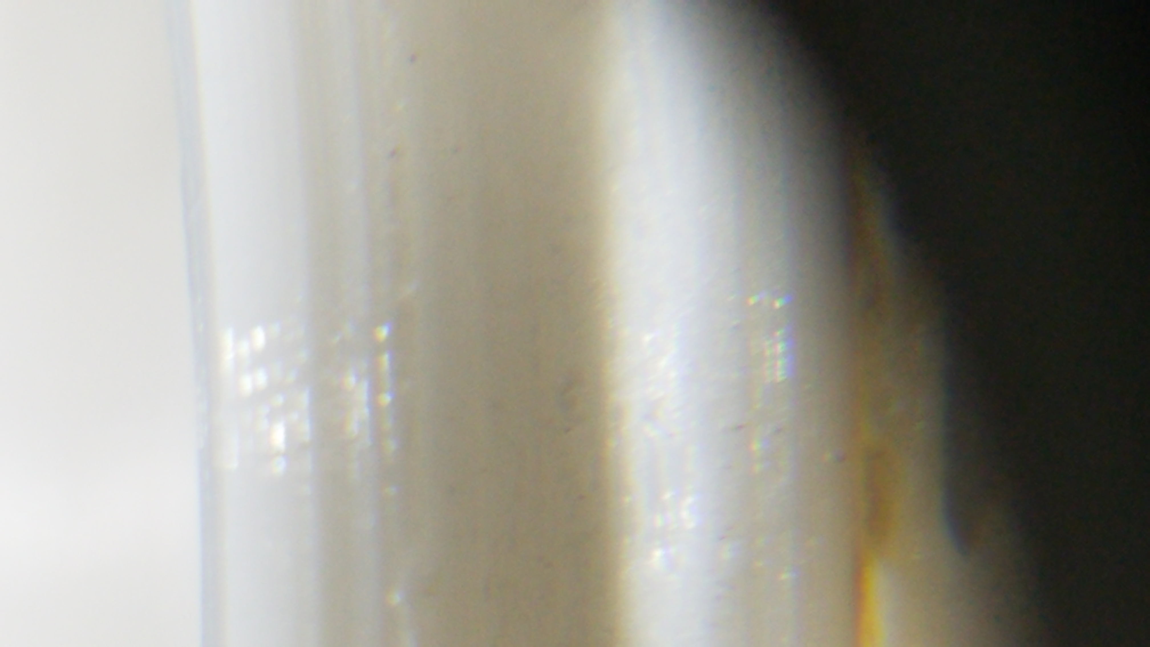

Post by airscapes » Thu Jun 28, 2018 11:57 pm

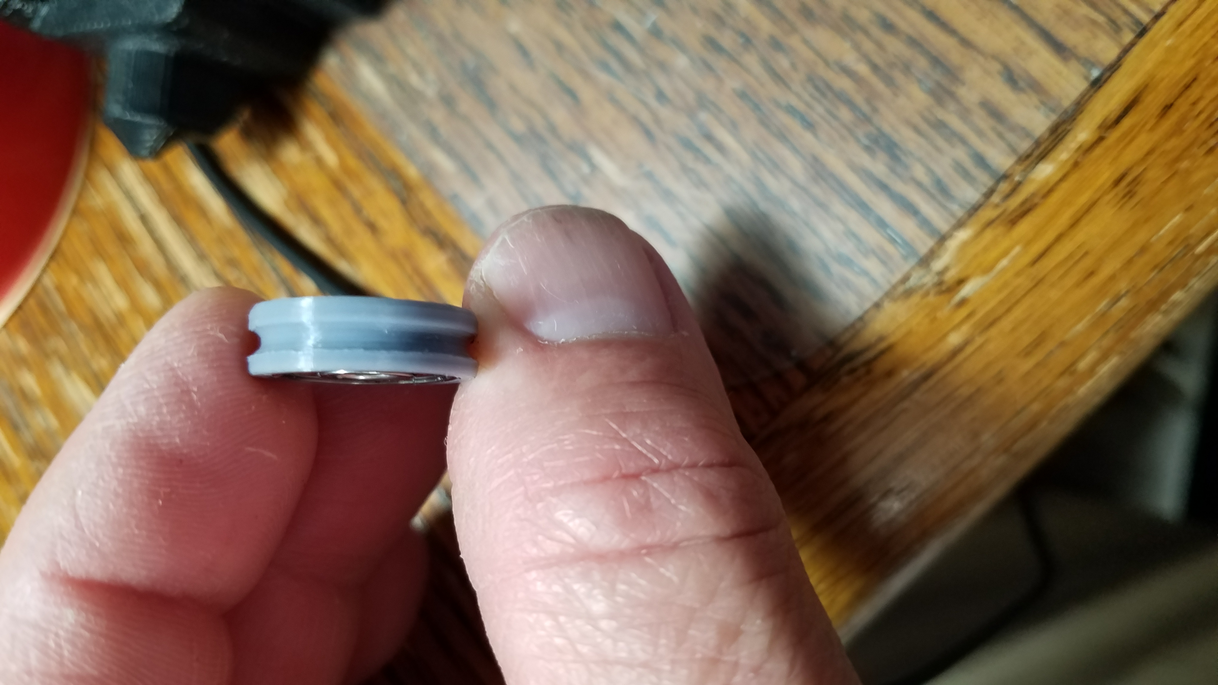

First print in PLA done and fits great. I did not use support and it looks like the grove is not symmetrical and thicker on the bottom half. Next up will be to "Try" and print it in PETG with the currently installed .25 nozzle.. It fits in the OEM housing but I dont have an extr shaft and nut. It lines up whit the hole with a little to spare but I don't think it will move close enough to the drive gear to get a good bite without hitting the houseing on the gear side. I would guess a file could fix that. First a reprint in PETG and then maybe EPA? EPA is more flexible but also very stable when it come to temperature from what I can tell.

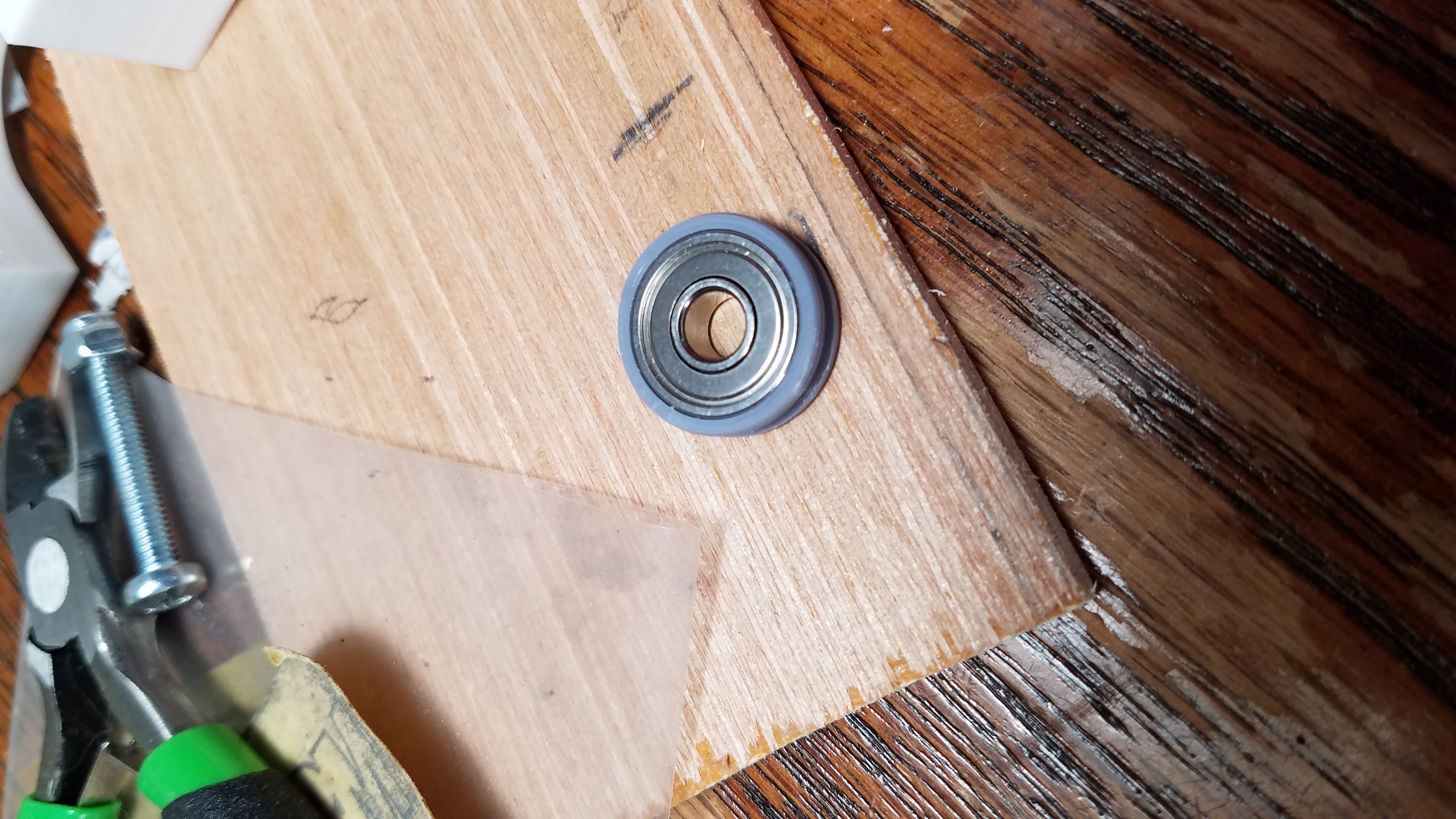

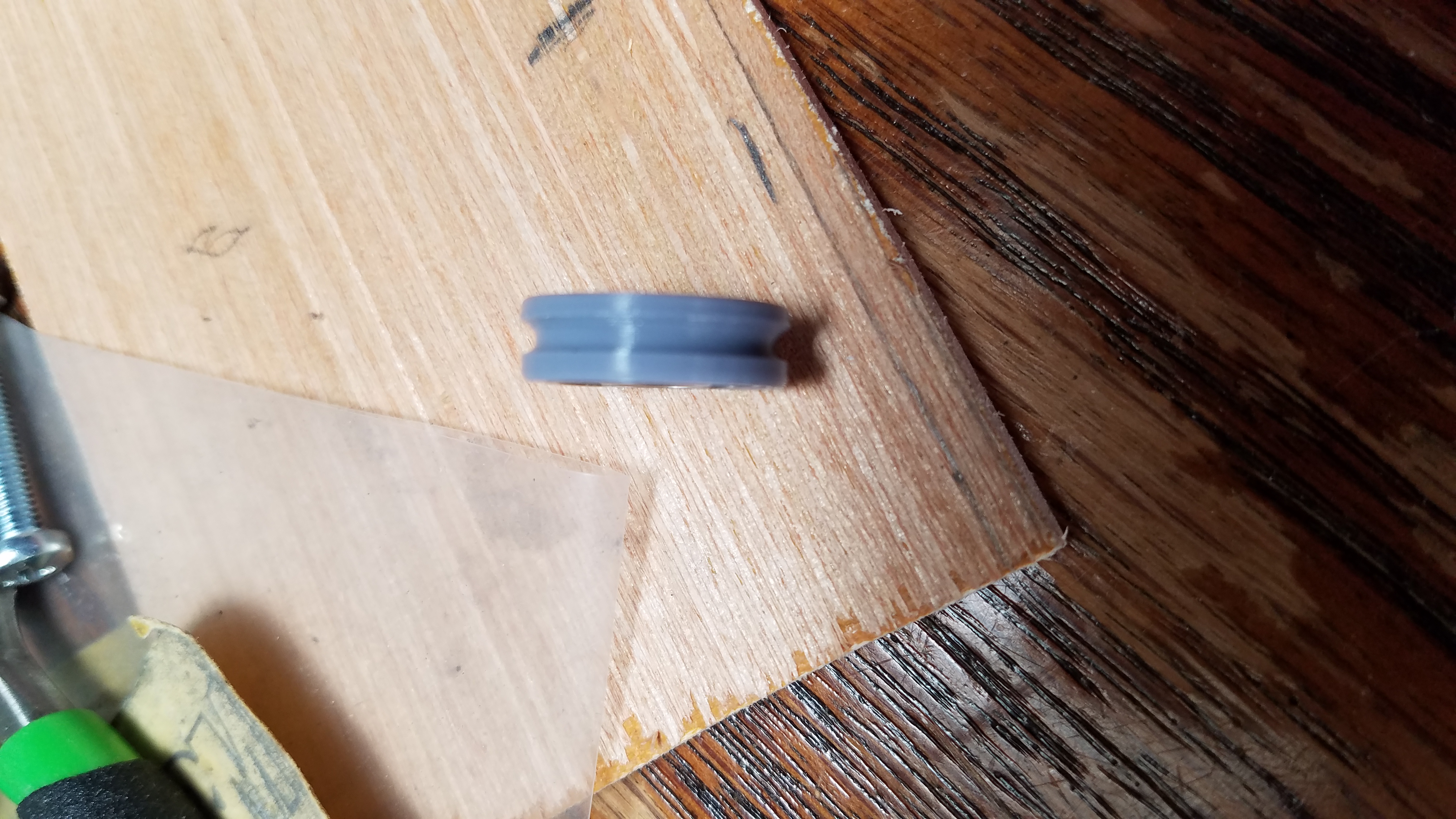

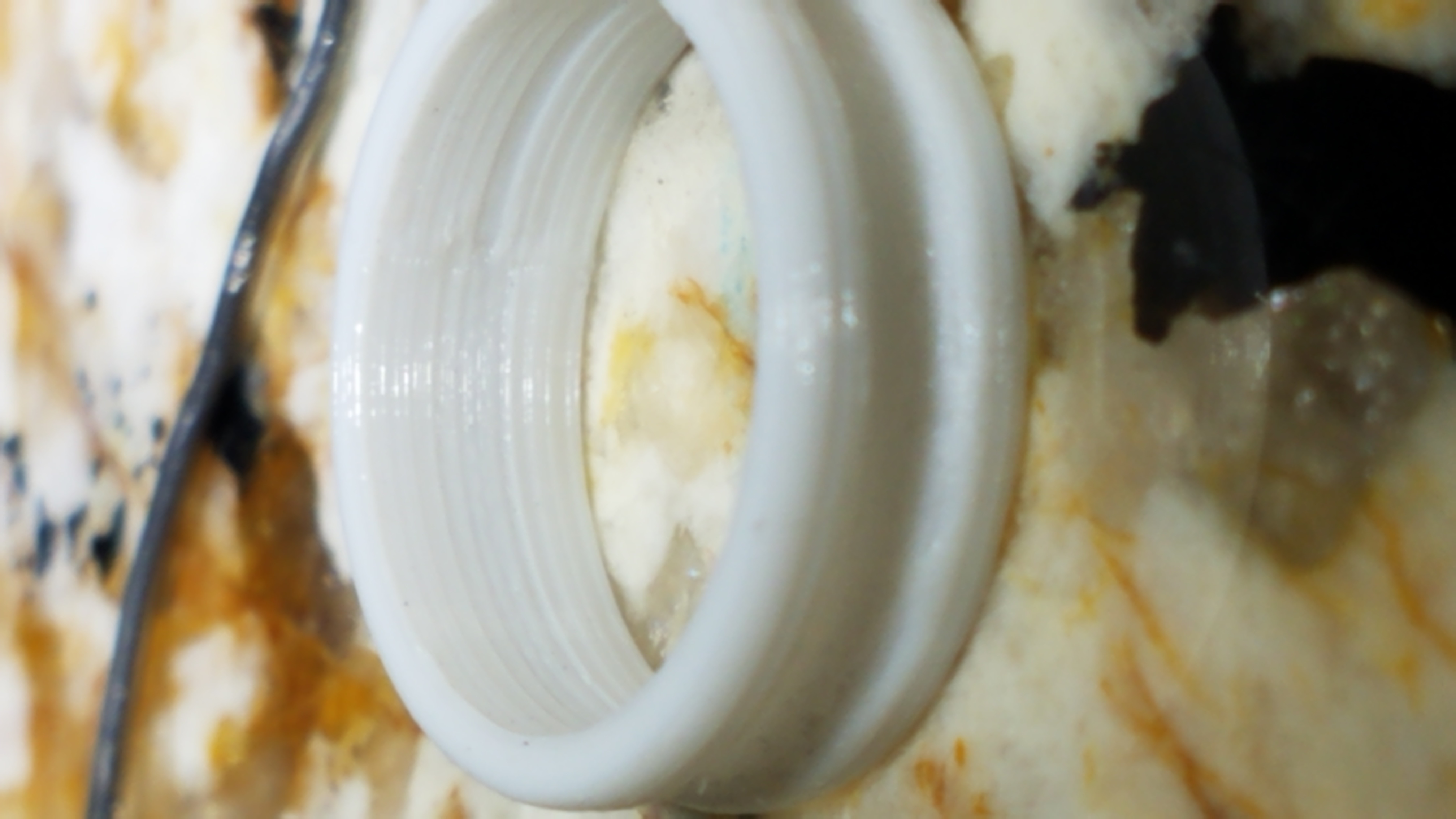

Post by airscapes » Fri Jun 29, 2018 1:57 am
PETG with lots of support turned out fairly nice.. will have to wait till tomorrow night to try it out.
