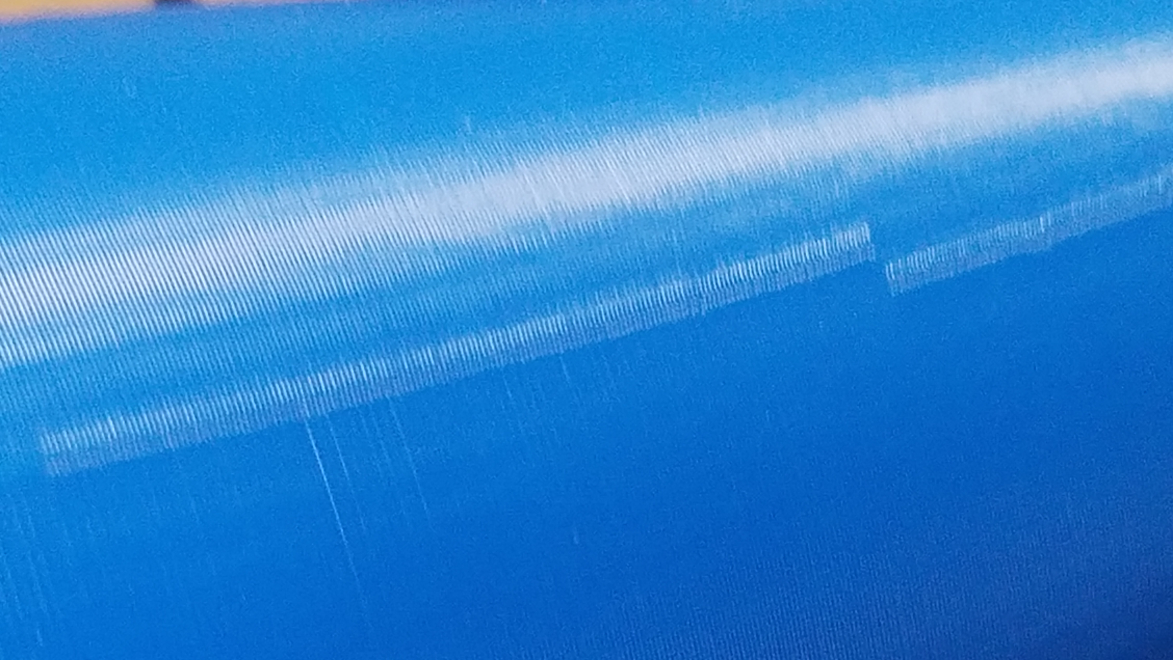

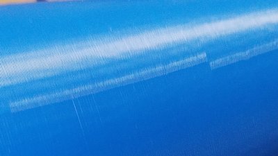

The problem is that I get a groove where the extruder leaves & returns from printing the support section:
The best I've managed is printing at 215C, with 0.5mm retraction, +0.15mm extra restart distance, no coasting and printing in-to-out. I can't tell if the groove is the result of under-extruding before it goes off to print the support, or when it comes back (or both...)

Actually, it isn't just the layer change. The layer change groove/line I'm used to, but there is a much larger defect when the layer change is combined with going back & forth to the support section:
As Ed pointed out, the pause between printing the regular & support section is longer than just going from layer to layer, which could be making things worse. However, it doesn't appear to be affected by the XY speed. If Ed's theory is correct, the higher XY speed should help, because the extruder has less time when it isn't extruding. Also, the distance between the regular & support sections is least where the defect is worst, which also implies that the problem isn't with the idle time between sections.
